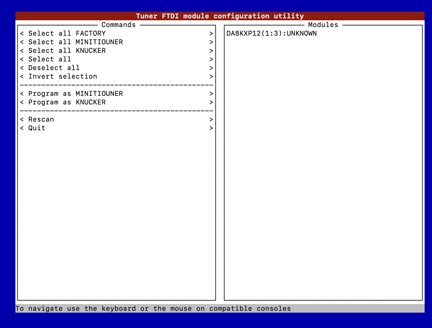

Post by DK1KIK » Sat Sep 09, 2023 8:53 am
Configuration Utility says
Modules:DA8KXP12 (1:3) : Unknown

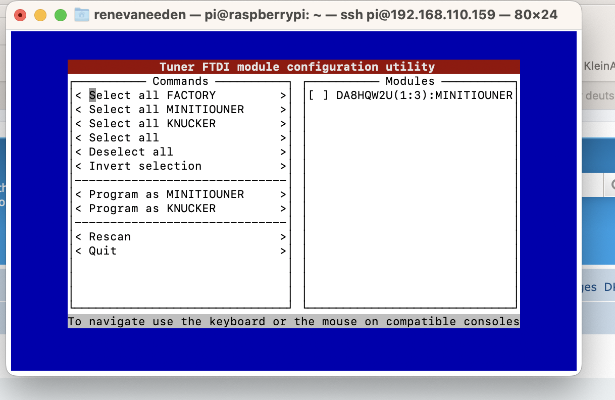

DK1KIK
Posts: 14
Joined: Wed Aug 30, 2023 12:22 pm
Re: ELAD Minitiouner
Post by DK1KIK » Sat Sep 09, 2023 9:33 am
ok, I think I solved the problem, I programmed the Tiouner with the "using NIMM Tuner" Template, The tuner is now recognized as a “minitiouner”.
Thanks to all
Rene
