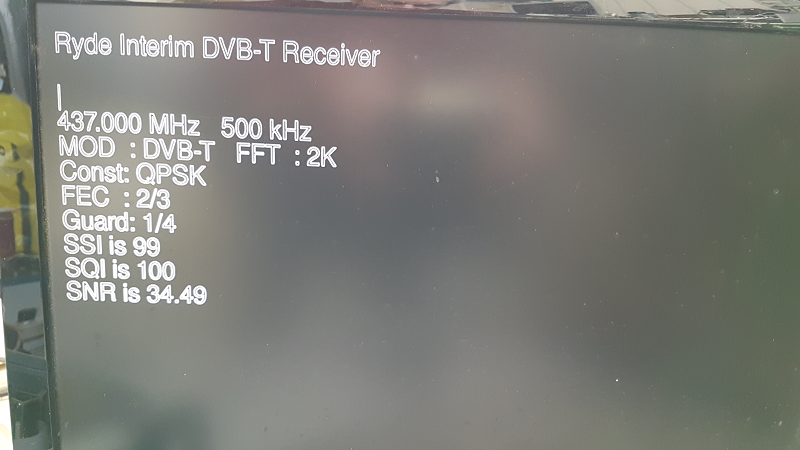

The screen is black and the text in white and the sound and ok see photo of the monitor screen in HDMI
I do not know what to do !

The final version of the Ryde DVB-T receiver is integrated with Ryde. So if you go into the Ryde on-screen menu, and then scroll through the presets, you will find some DVB-T presets. You can adjust those using the remote control, or amend them (use a text editor on the file ryde/config,yaml).
The interim receiver does not activate the GPIO line. The final version should do.
G3GJA

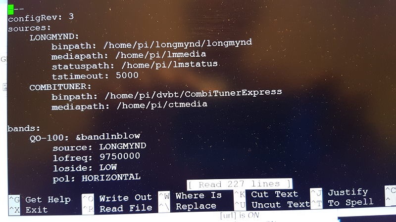

what do we edit in the config.yaml ?
Philippe
Posts: 14
Joined: Wed Dec 14, 2022 12:38 pm
Re: Ryde in Gb3EY faulty?
Post by Philippe » Wed Dec 21, 2022 6:44 am
Hi Dave
What should I modify in the config.yaml file to have the image instead of having a black screen with the indications in white??
I find it weird that no one has the same problem as me.
thank you for your reply
73 Philippe F5AOD

If you want to modify the config.yaml file, the items that you need to modify are further down, so use the "page down" key to see them.
Your big problem is that you are using the ssh menu to control the Ryde, not a Remote Control and the on-screen (HDMI output) menu. For proper DVB-T operation, you need to select a DVB-T preset from the on-screen menu, just like you would select a DVB-S/S2 preset. Scroll through all the presets (slowly)and you will see what I mean.
