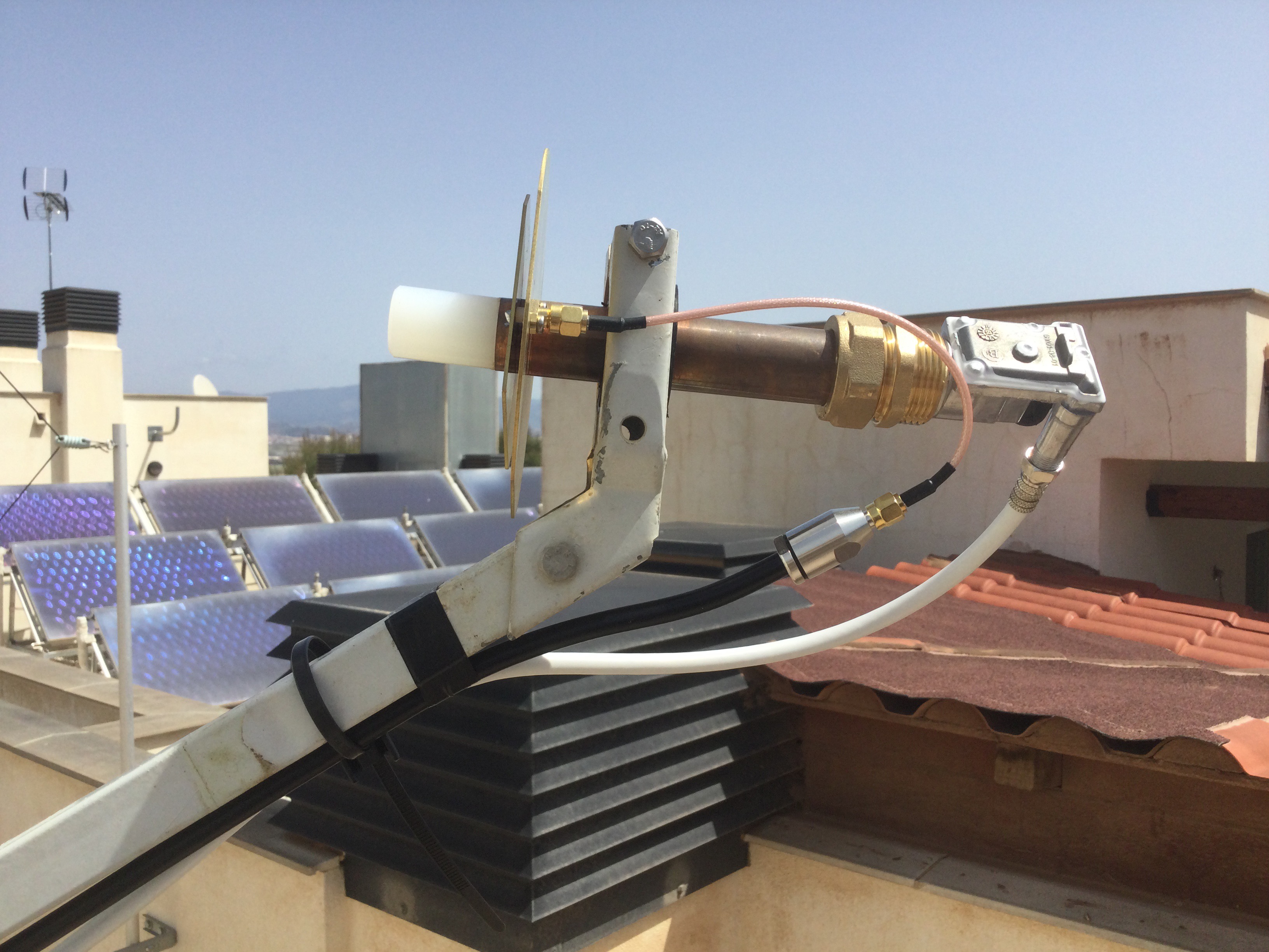

I am worried about that entirely inadequate looking SMA patch lead and cheap N-SMA adapter. Don't put much power through those.
The offset should be 9750MHz. The Bullseye has two F-connectors. Only one is the correct one. Make sure you are using the right one which is the green one. Looks OK in the photo - unlike the LNB offset which looks incorrect.
I assume you want the cables pointing down so instead of rotating clockwise (Offset + 90 = approx 124) subtract 180 degrees and rotate it 180 - 124 = 56 anticlockwise, (or just rotate back 90 degrees from where it was in your case).
However, even if quite a way out it should still get the beacon with a 1.3m dish. I wonder how you set the focal length? I can't see from the photo.
You must, must, must, must, must allow for the focus of the POTY feed to be in the correct place once modified. Don't just clamp the LNB where it was when set up without the POTY feed. If you do that the feed will be far too far forwards and it won't work at all.

The skew looked a little out but it might be OK, hard to tell but it won't be that critical. That SMA patch lead won't handle 40W for very long I suspect but first you need to get the RX working so let's see a side elevation. Do you know the F/D of the dish?
How did you modify the feed holder to move it backwards?

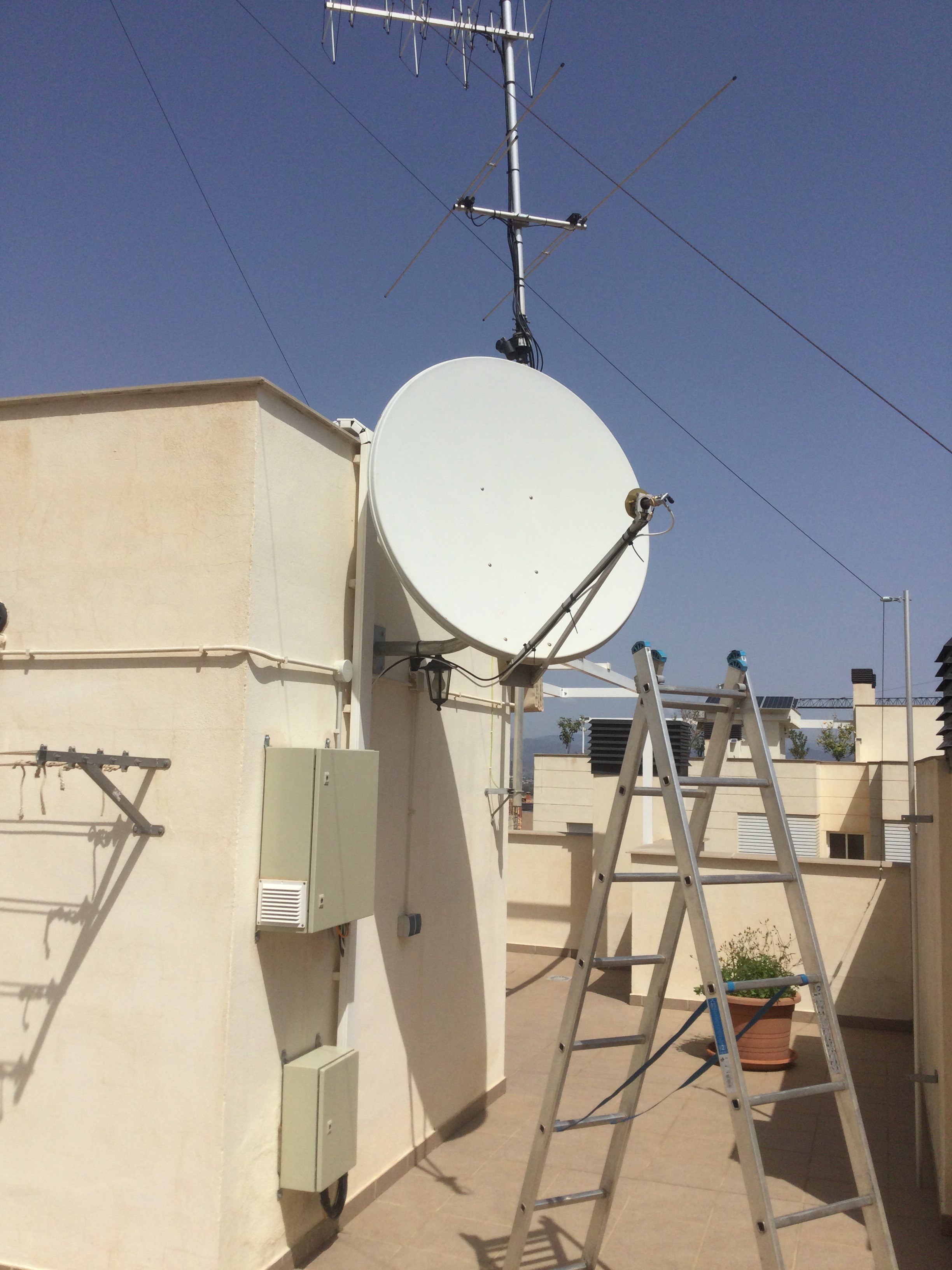

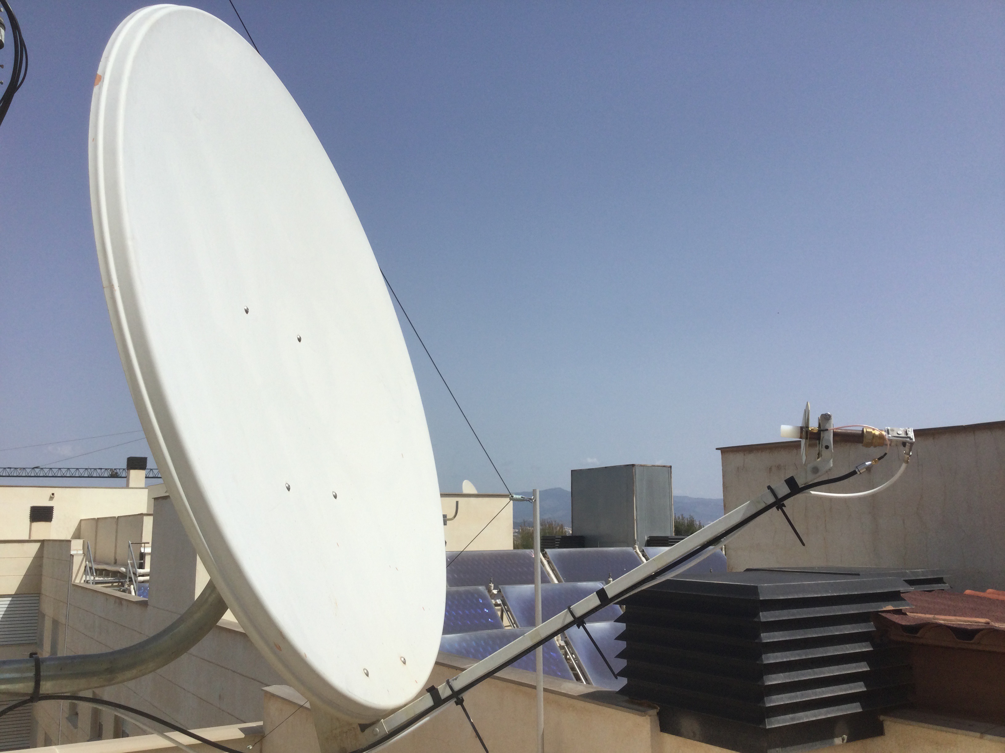

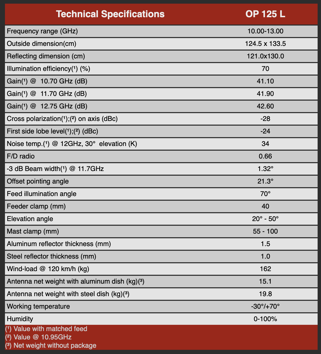

The dish is a Gibertina OP 125 L with F/D 0.66. The thought of having to make a replacement feed bracket is daunting. Buying small quantities of metal down here is challenging and I don't have the necessary tools. Do you think a different shape lens would help? Here's a few photos showing the entire thing. The large enclosure houses the server, receiver and transmitter. The smaller one houses all the tie lines coming up from my office/shack.

This is the exact same dish that I and others on this forum are using. I've not had any issues with the POTY feed combined with the Bullseye LNB. As Mike said focus is critical and I achieved it with standard dish hardware.

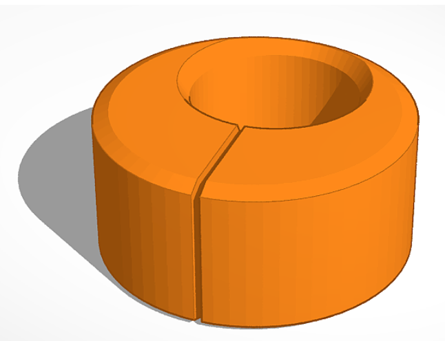

It just needs to come back a few cm, the middle of the lens needs to be about where the face of a standard LNB would be. Push back as far as you can, see if it makes it better. You may have to tweak the dish pointing a little as once in focus it will be more directional.
If the feed doesn't move back enough you don't need to cut metal. It looks like there is room but if you find the feed reflector fouls against the feed arm, then raise the height of the feed a little. I can see from the photo there is a 22mm to 40mm round adapter. If you were to make another with the hole higher up it would fix this. You will probably need to re-adjust elevation. Like this. 3D print it or make it from a bit of wood.
I don't think the supplied lens is much good but that's all you have. Passion Radio do sell a better one designed by HB9PZK.
The SMA patch lead really isn't up to the job of handling 40W for long periods at 2.4 GHz. Please try and find a better one. That looks like RG178 / RG316, which is only rated to 3 GHz. The power rating of good quality, mil spec cable like you get from Huber Schuner is 60W at 1 GHz. There isn't a power rating given for 2.4 GHz but the attenuation is greater, 40W would be pushing it. I know it is only 6 inches long and the loss is only 0.4 dB or so, but 0.4 dB is 5% of the power and 5% of 40W is 2W which is a lot of heat in that little cable. Better would be RG142 or similar 5mm dia PTFE coax. That's what I am using, but I use only 10-20W.

There are so many things that might be just not correct, sufficient to prevent reception. I suggest you remove the complete feed set up and replace it with a standard, un-modified LNB. Use this to prove and optimise the dish alignment. Once that is done, you can then try the feed set up you have, knowing that a signal is present. A dish of that size is very touchy to get correctly aligned. How did your installer align it to the correct satellite?
