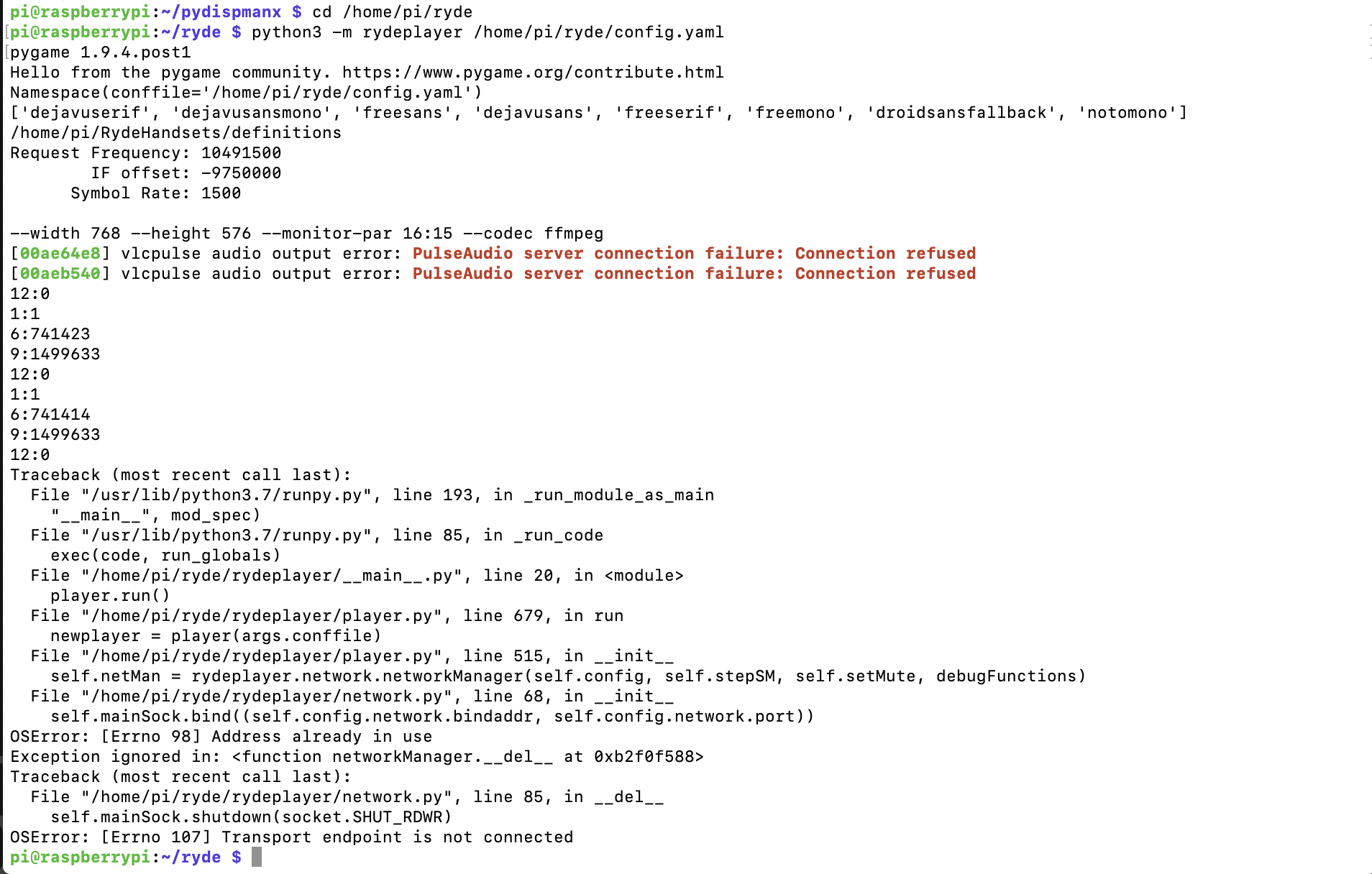

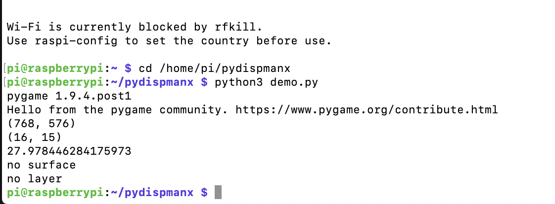

I have a new upgraded power supply and a completely new install (using the latest version). I can get a picture/sound on composite video and it decodes transmissions ok even though it says "Long Mynd not loaded". I still cannot get HDMI on either monitor or tv.
The code you asked me to run some time ago now gives the results attached.
Once again I appreciate your time and and your help.
Richard
Richard

Re: Ryde software 403 forbidden
Hi Richard,
I have 2 ideas that should help us make some progress:
- Can you confirm if you are using the HDMI port closest to the USB port?
- Can you make sure you stop ryde from the console menu and wait a few minutes before trying to start it manually and post the output? The network error is likely unrelated but is masking your actual issue.
Code: Select all
cd /home/pi/ryde python3 -m rydeplayer /home/pi/ryde/config.yaml
