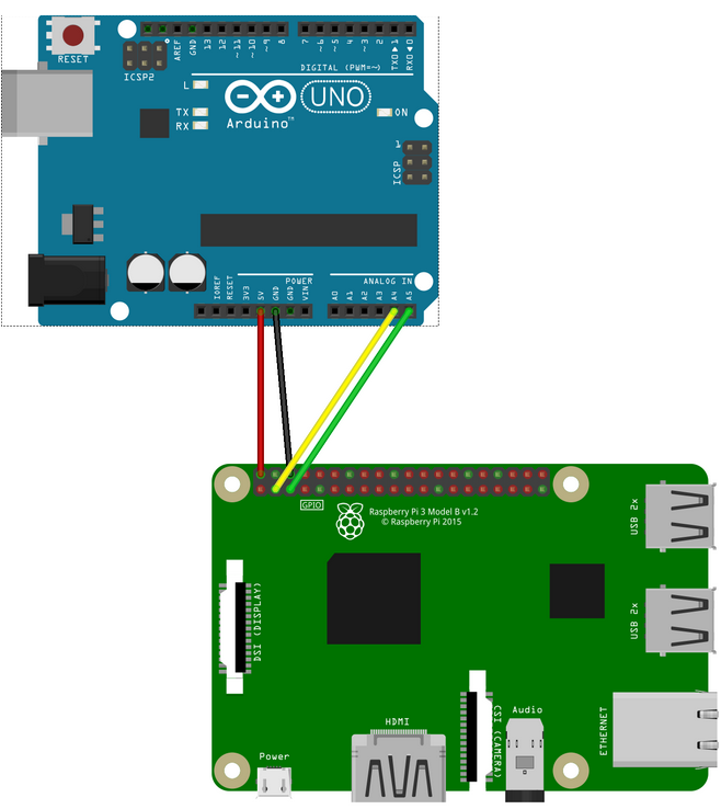

So to make the Arduino LED come on when 'Longmynd not Loaded' crash happens it hasto be connected to the RPi as in the diagram:
RPi to Arduino.png (166.08 KiB) Viewed 3811 times

If you have the Arduino and a minituoiner connected you should be able to reboot the RPI using
menu
and selecting reboot.
The RPi should reboot and just as it gets going it will go through 'Longmynd not Loaded' and flash the LED of the arduino then work as normal. If the minituoiner is disconnected the LED will stay on.
