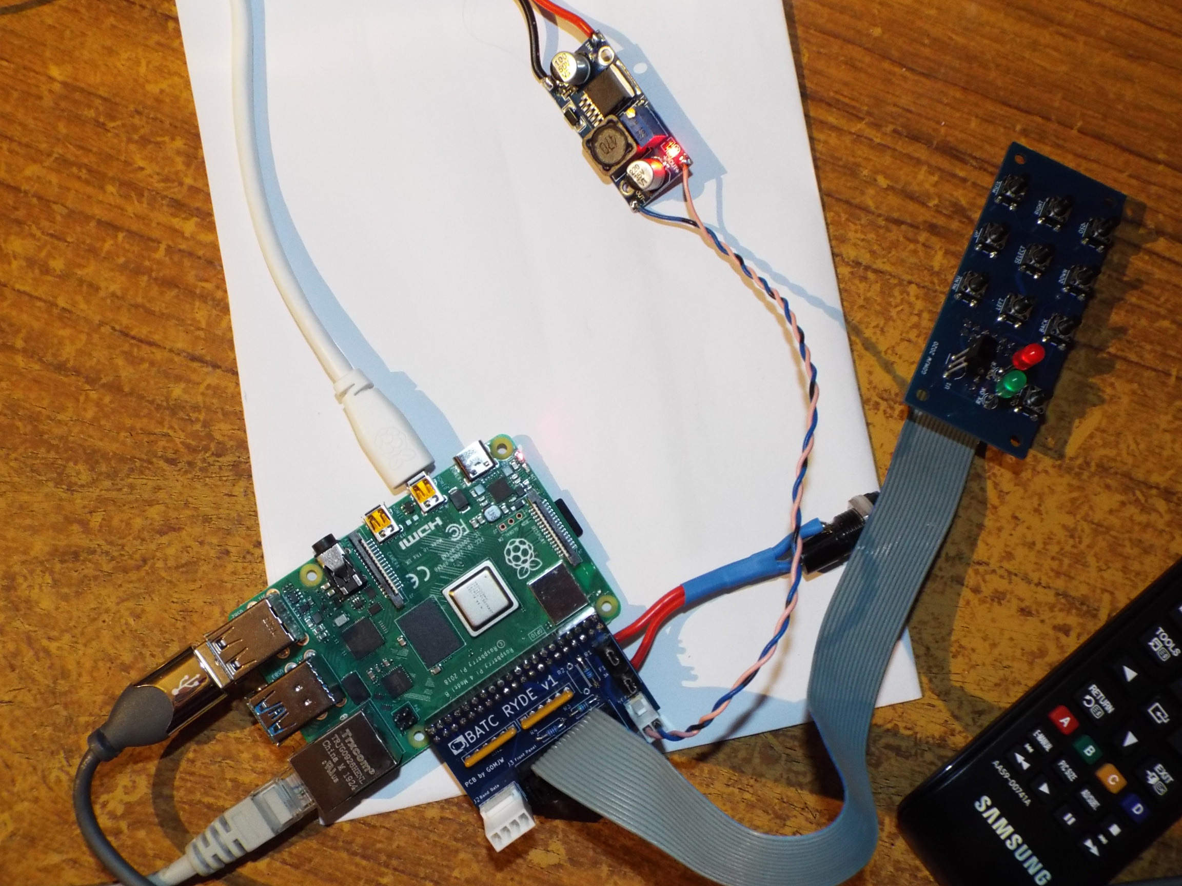

Hi Tim,
Yes - in the correct HDMI port.
Phot attached showing setup configuration on desk.
Setup Configuration
Setup Configuration
Ryde Setup.jpg (977.97 KiB) Viewed 6791 times
Regards,
Nick.

Thanks Nick,
Can you try running the pydispmanx demo and paste the output and let me know if you get flashing circles on the screen while its running:
Log in by ssh, then:
Code: Select all
cd pydispmanx
python3 demo.py
Tim

I have the buck converter seen in the photo set at 5.1V.
Where would an undervoltage or over temperature warning appear in this setup ?
Regards,
Nick.

Hi Nick,
Pi say you need to be able to supply 3A for the Pi4, which would be more my concern than the set voltage on the buck converter. Transient undervolts on the Pi can cause all sorts of strangeness as I'm sure Dave has plenty examples of from Portsdown :D
If there is a problem you should get little icons in the corner of the display as described here: https://www.raspberrypi.org/documentati ... g-icons.md
Tim

Checked and there are were no voltage or temperature warnings on the HDMI monitor. Measuered the voltage on GPIO pins 2 and 4. It was 4.89, and while measuring a text message on the screen appeared saying low voltage.
Set the voltage higher to 5.2V and measuerd 5.15V on pins 2 and 4. Still got the LongMynd Not Loaded message. Tried the minitiouner in the USB3 port of the Pi4 and still the same.
So tried disconnecting the breakout board and using an official Pi4 PSU and still not working.
Should the receiver work, or at least should Longmynd load, without the breakout board being fitted ?
At a loss to know what is wrong with this.
