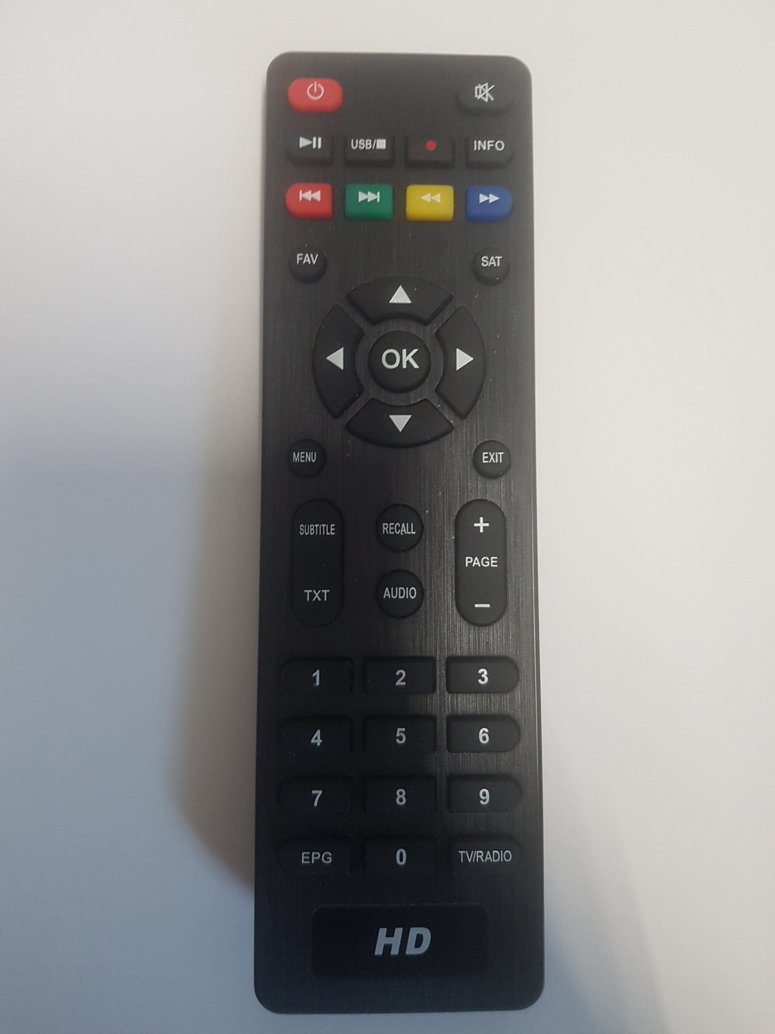

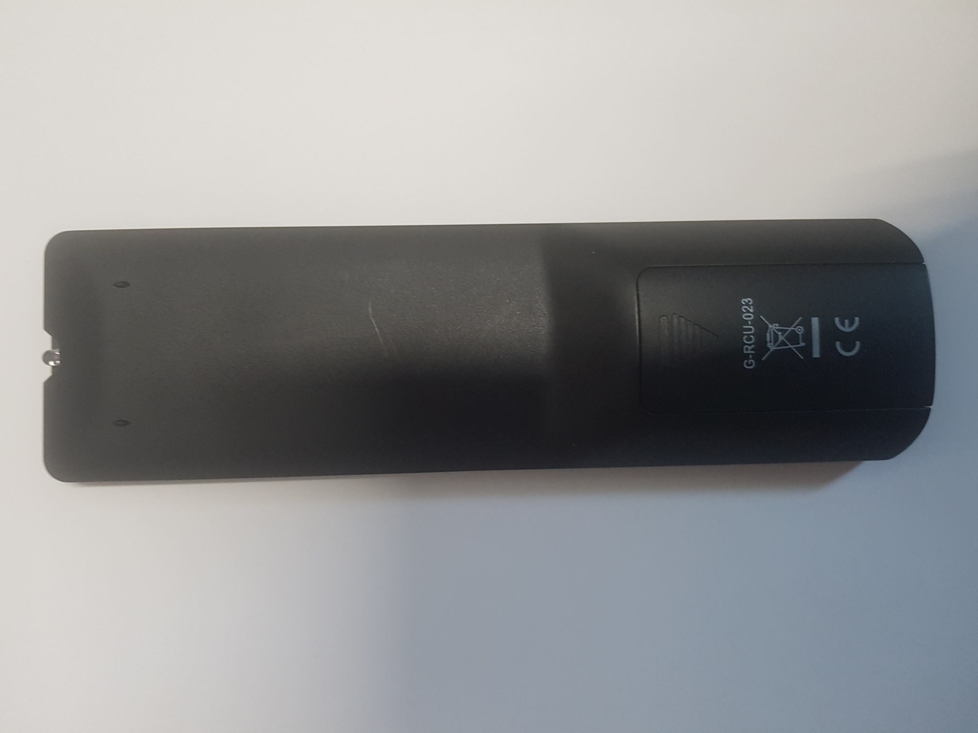

Hi @all,
I have read out or learned a remote control.
It is a smaller remote control from an Opticum HD AX150.
On the back of the remote control it says: G-RCU-023.
driver: nec
buttons:
POWER: 0x1fddc
UP: 0x1fdde
DOWN: 0x1fdd6
LEFT: 0x1fddb
RIGHT: 0x1fdd8
SELECT: 0x1fdda
BACK: 0x1fdd7
MENU: 0x1fdd4
MUTE: 0x1fd8b
VOL+: 0x1fd9d
VOL-: 0x1fddd
CHAN+: 0x1fdd0
CHAN-: 0x1fdcc
ZERO: 0x1fd9a
ONE: 0x1fd8e
TWO: 0x1fd86
THREE: 0x1fd8f
FOUR: 0x1fd92
FIVE: 0x1fd87
SIX: 0x1fd93
SEVEN: 0x1fd96
EIGHT: 0x1fd82
NINE: 0x1fd97

Thanks Thomas
Added to the list for the next update.

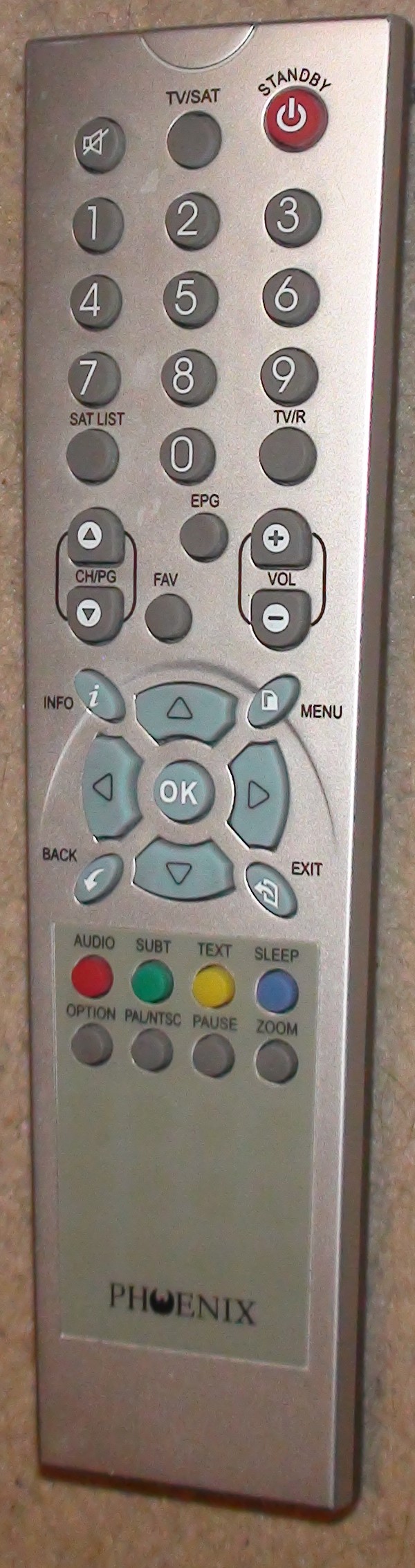

Here is the details for the Phoenix satellite RX remote control
driver: nec
buttons:
POWER: 0x15f
UP: 0x118
DOWN: 0x146
LEFT: 0x141
RIGHT: 0x149
SELECT: 0x145
BACK: 0x142
MENU: 0x11c
MUTE: 0x157
VOL+: 0x11e
VOL-: 0x11d
CHAN+: 0x116
CHAN-: 0x115
ZERO: 0x11b
ONE: 0x156
TWO: 0x15a
THREE: 0x15e
FOUR: 0x155
FIVE: 0x159
SIX: 0x15d
SEVEN: 0x154
EIGHT: 0x158
NINE: 0x15c
And Photo
I went to the directory mentioned in the intructions with
cd /home/pi/RydeHandsets/definitions
then used nano to cut and paste the above into a file.
I then cheated by saving the file as virgin.yaml
This means it comes up with the right remote without changing anything else.
It might be easier, if you are having trouble to setup your spare remote, just to use nano to edit virgin.yaml with your details (from menu item 7 )and try that.
Martin G8LCE

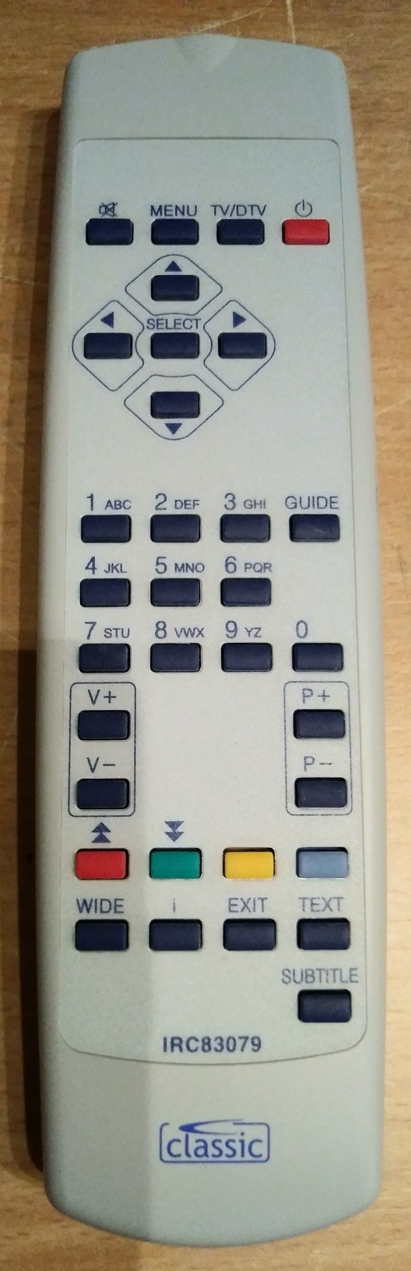

Here's another remote control. Not sure what it belonged to, but it's labelled Classic, IRC83079.
driver: rc-5
buttons:
POWER: 0x80C
UP: 0x812
DOWN: 0x813
LEFT: 0x815
RIGHT: 0x816
SELECT: 0x814
BACK: 0x80A
MENU: 0x835
MUTE: 0x80D
VOL+: 0x810
VOL-: 0x811
CHAN+: 0x820
CHAN-: 0x821
ZERO: 0x800
ONE: 0x801
TWO: 0x802
THREE: 0x803
FOUR: 0x804
FIVE: 0x805
SIX: 0x806
SEVEN: 0x807
EIGHT: 0x808
NINE: 0x809

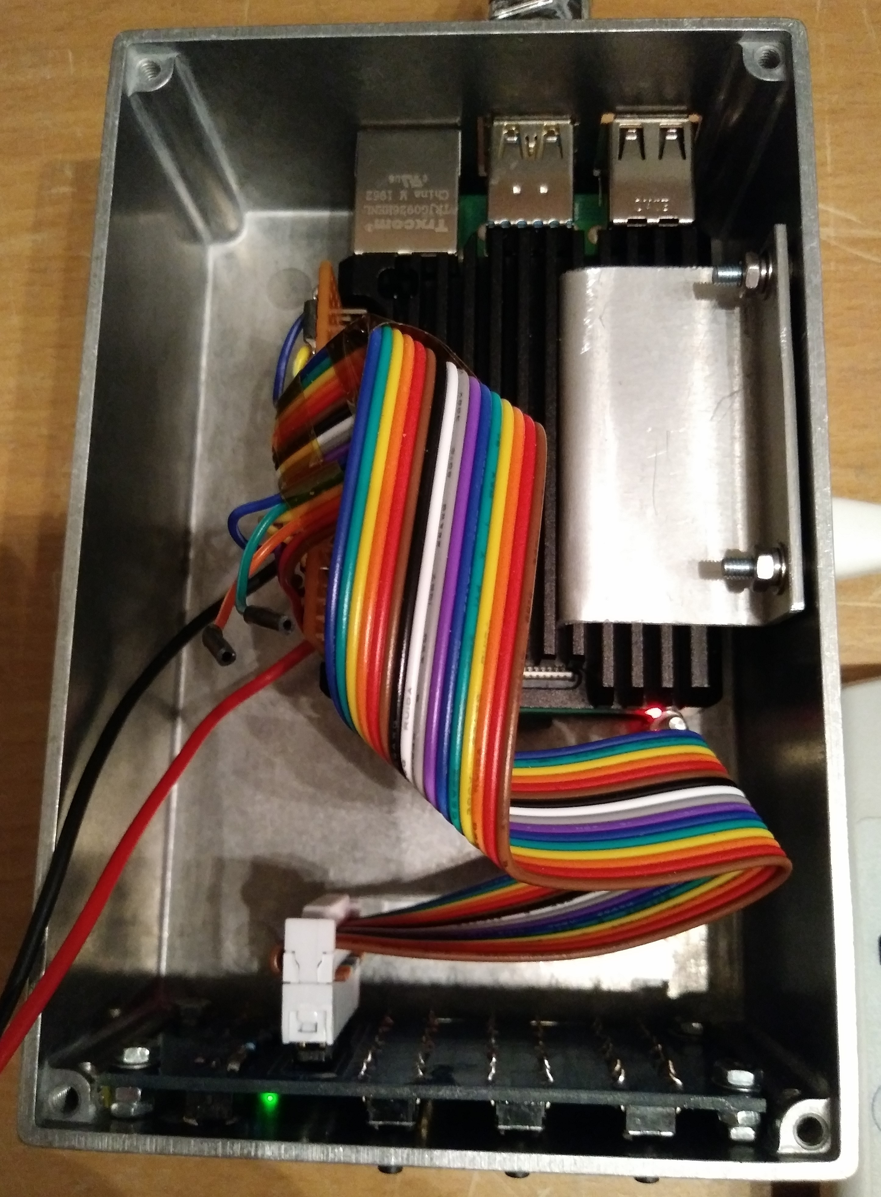

And RC photo, plus a photo of the Rx that uses an external tuner.

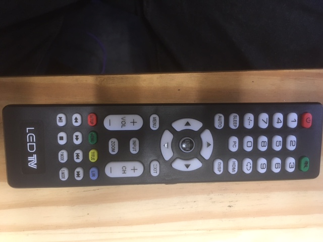

driver: nec
buttons:
POWER: 0xbf00
UP: 0xbf13
DOWN: 0xbf14
LEFT: 0xbf11
RIGHT: 0xbf12
SELECT: 0xbf10
BACK: 0xbf4b
MENU: 0xbf16
MUTE: 0xbf01
VOL+: 0xbf48
VOL-: 0xbf49
ZERO: 0xbf0c
ONE: 0xbf02
TWO: 0xbf03
THREE: 0xbf04
FOUR: 0xbf05
FIVE: 0xbf06
SIX: 0xbf07
SEVEN: 0xbf08
EIGHT: 0xbf09
NINE: 0xbf0a

Thanks for the new remote Keith.
Please could you rechceck the protocol (driver) that it uses? It is probably nec, but could be rc5.
Re: IR Remote Controls for the Ryde Receiver
Hi Dave
Sorry its nec
