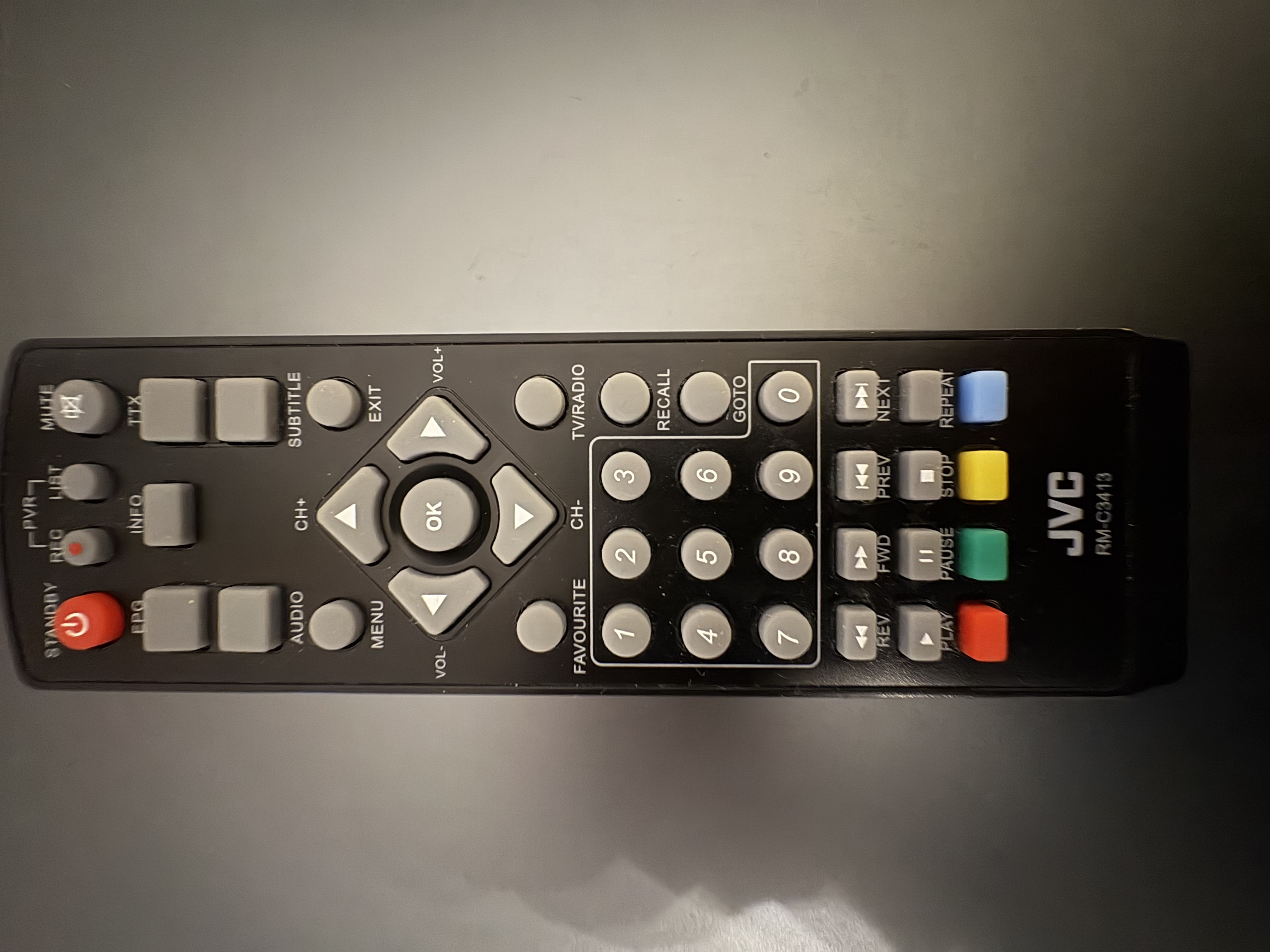

I created a customized configuration file for a JVC remote control from a "TNT" (french terrestrial DVB-T) decoder
So I share it (see also the two attached pcitures)

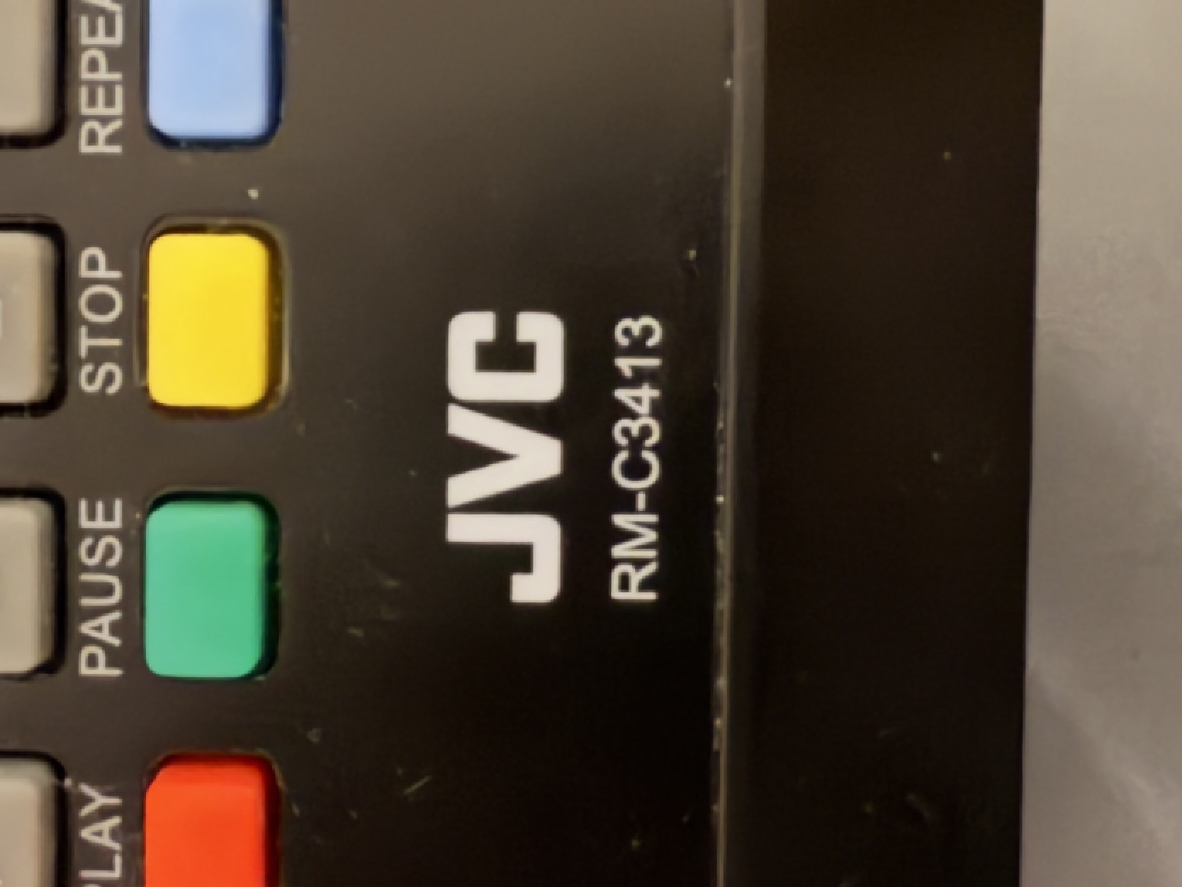

Reference of the remote control : JVC RM-C3413
Protocol: nec
Configuration of the keys that I have chosen:
driver: nec
buttons:
POWER: 0xbf59
UP: 0xbf06
DOWN: 0xbf16
LEFT: 0xbf4a
RIGHT: 0xbf48
SELECT: 0xbf1a
BACK: 0xbf05
MENU: 0xbf45
MUTE: 0xbf19
VOL+: 0xbf1b
VOL-: 0xbf5a
ZERO: 0xbf0f
ONE: 0xbf52
TWO: 0xbf50
THREE: 0xbf10
FOUR: 0xbf56
FIVE: 0xbf54
SIX: 0xbf14
SEVEN: 0xbf4e
EIGHT: 0xbf4c
NINE: 0xbf0c
OSDTOG: 0xbf0e
Notes:
- this model is quite basic ... the left/right arrows around the Ok (which is used as "select") are indicated as "vol-" / "vol+" so i kept them for the audio volume tuning .... for left and right I decided to use the "rew" and "fwd" keys (botton left corner of the keyboard)
- OSDTOG is on the "info" key
- Back is on the "exit" key
Conclusion: it works !
