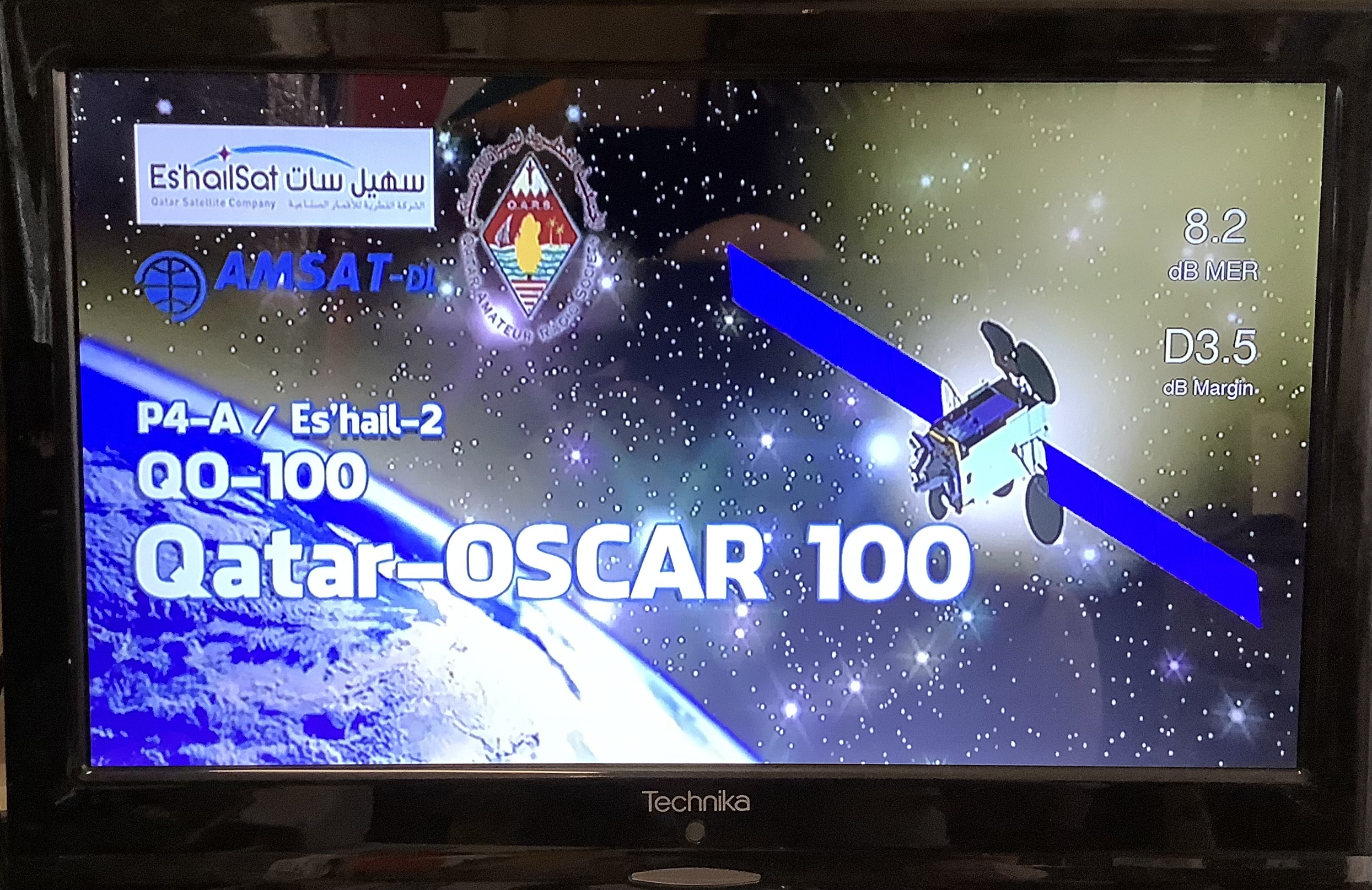

Post by g6hfs » Tue Apr 02, 2024 11:04 am
Hi Dave,
No issues so far with picotuner on the ryde, will update if any found.
