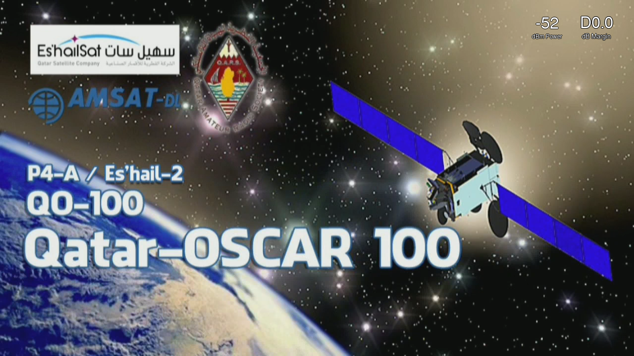

I've copied the settings you gave into a stock config file and they appear to work as shown in this screenshot
