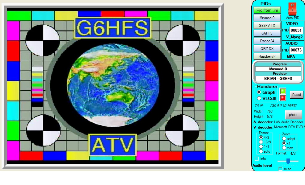

My mistake it's MPA audio, my problem is the MiniTiouner will work, but when connected to Ryde plus MiniTiouner there is no sound.

- Untitled.jpg (216.93 KiB) Viewed 4597 times

I should also add the ryde system is trying to decode audio as MP3, not MPA

I tried receiving DVB-S from a DTX1 and the sound was fine on the Ryde.
Can you record your transmission with MiniTioune and post it. 5 seconds worth should be enough.

I only have the problem on the Ryde for my own tx all other stations are good, the minitiouner connected to the pc is no problem and decodes sound as mpa and works fine, its just the Ryde that does not decode mpa by the looks of it.

A recording would be helpful for future reference. It should be put in the folder where MiniTioune lives. There are 3 different audio stream types that Ryde identifies as MP3, so it would be useful to know which one is giving problems.

Update,
I was on the wrong audio input channel on my tx, all sorted now
