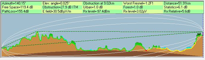

G4CPE, who could not access HV previously, can reliably access the system over an 82km path and Mike G0MJW can get in with less than 1 watt over a 54km definitely non line of site path.
