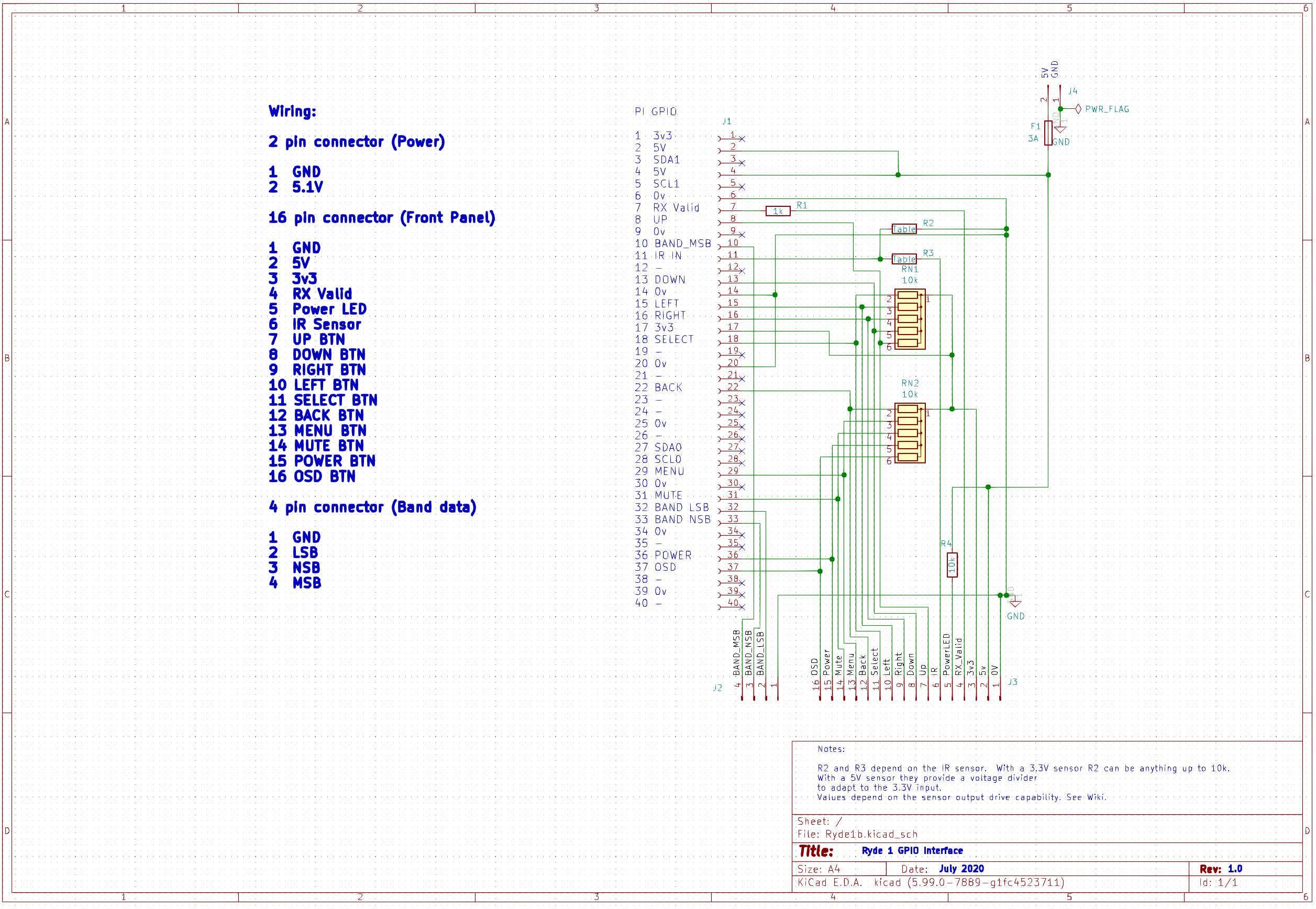

I made my own interface board.
The lock is a simple pin 7 to a resistor to the LED to ground.

Are you using the standard build? Have you put anything else on the SD Card?
Please could you post some photos of your interface board?

That was the older version. Are you sure it's on pin 7? It works on all the other versions. Have you ever in the past connected 5V to the GPIO ? That would break it.
