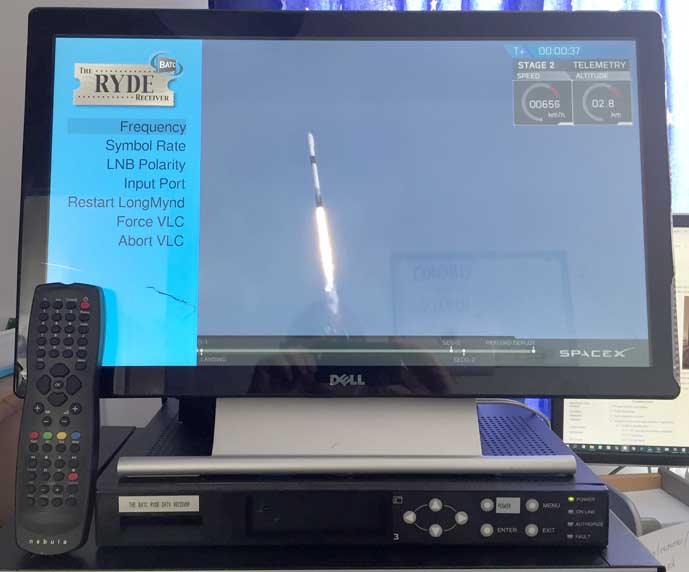

Thanks to some amazing work by Tim MW0RUD, an early version of the Ryde Digital ATV Receiver is now available for download. It is very early days, so there are a number of limitations:
  • It only works with FTS-4334 Serit Tuners, not the early FTS-4335 tuners without an LNA.
  • It is single channel, and the frequency and SR can only be changed by using the remote control.
  • The correct remote control needs to be selected from an ssh console menu. Only a limited number of remote control types have been programmed, although it is possible to program your own.
  • It defaults to HDMI display. Comp Vid output needs to be selected from the ssh console menu.
  • The front panel buttons do not yet work (Tim has written the code, but I have not released it yet).
There are many items on the wish list here https://github.com/eclispe/rydeplayer/issues?q=. Please give Tim and the rest of the team time to solve the issues and do not raise any that are already there.
To get started, you will need:
  • A Raspberry Pi 4 (2 GB at least) and a 5v 3A PSU
  • A micro-HDMI to HDMI adaptor
  • An 8 GB+ Memory card
  • An IR sensor and IR Remote Control
  • An HDMI Display
  • A MiniTiouner V2 with FTS 4334 NIM
Initial hardware build details are on the Wiki here: https://wiki.batc.org.uk/Ryde_Receiver
Software build instructions are on the BATC GitHub page here: https://github.com/BritishAmateurTelevi ... ryde-build
