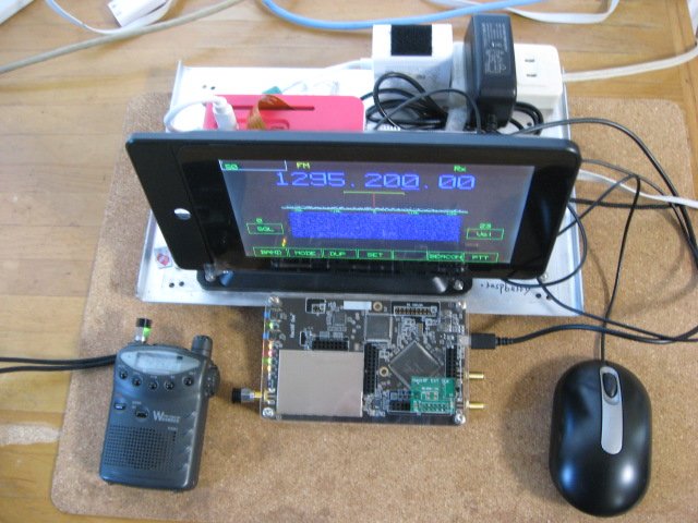

Thanks Colin for your update.
My HackRF One is working by LangstoneV3 on the Raspberry Pi 5.
Hiro JA1SYK
Hiro JA1SYK
