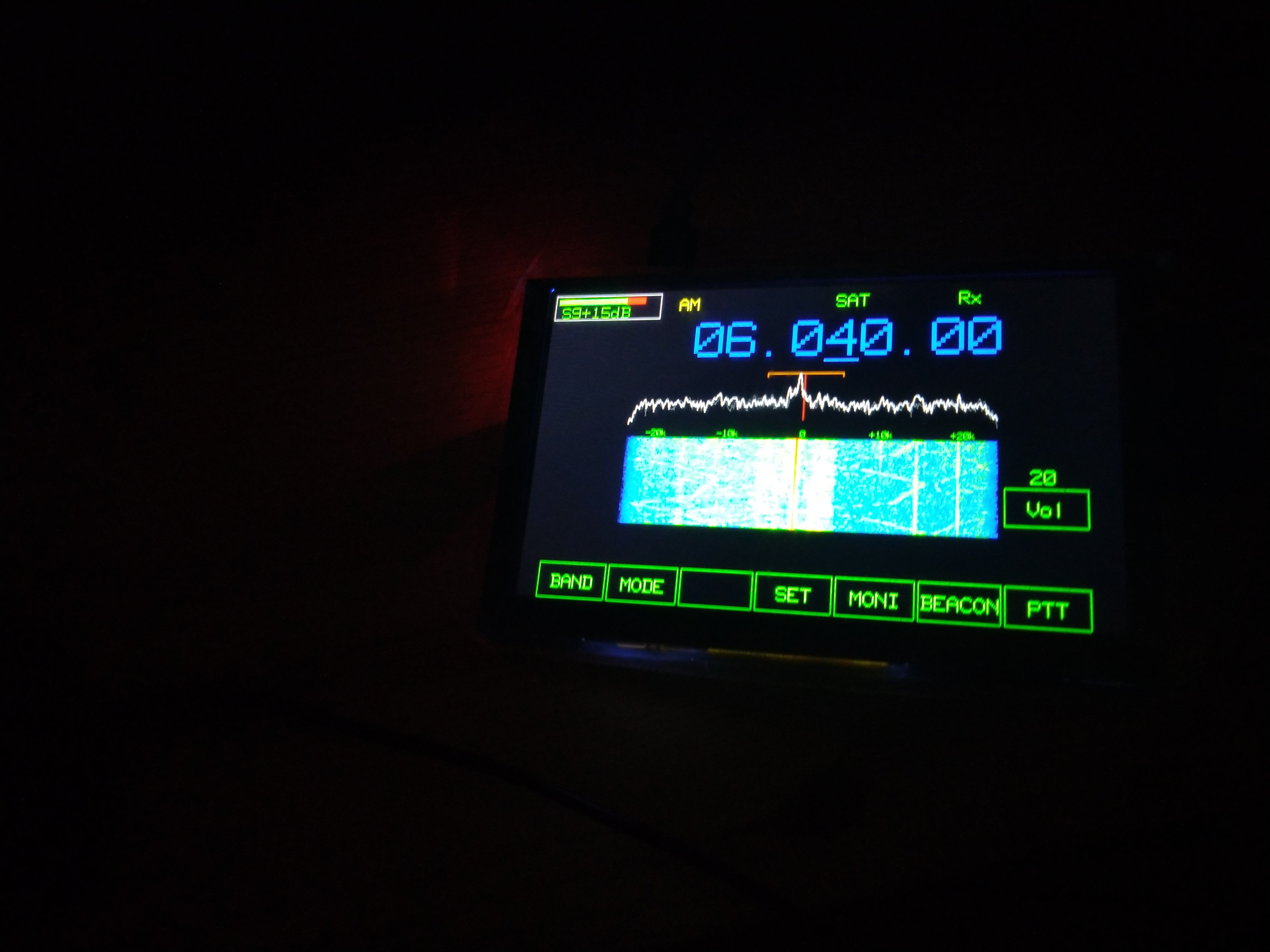

Hello colleagues! Once again, I want to thank Dave and Colin for developing it project!
I tested the project with Lime-mini. Everything works well. With the help of the HF converter for the RTL-SDR key, I even tried to receive HF radio. It was an interesting experiment.
- HF on microwave TRX
- IMG_20211124_210738.jpg (1.91 MiB) Viewed 15379 times
