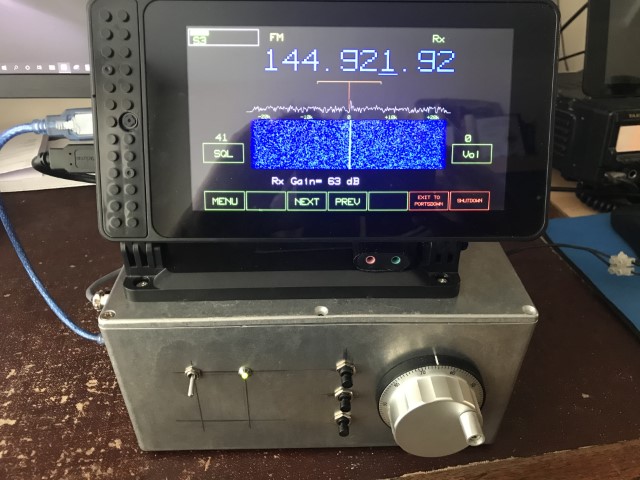

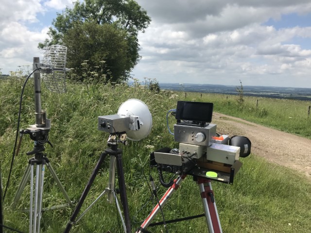

Now using the Langstone / Portsdown combo as my microwave transverter driver - had QSOs on 5.7, 47 and 76GHz with it and the waterfall just makes things so much easier :-)
I am still having issues with the Pluto crashing into DFU mode and requiring a rebuild but I think this is down to earthing - it's a rev D PCB and they claim to have fixed it...
The big problem I have is radiated noise from the RPi + screen getting into the 2 metre talkback rig. Tin foil and earth bonding helps but may have to end up putting it into a diecast box.
2 feature tweaks would be nice - a transmit power indication such as a not calibrated bouncy bar would be good. And the ability to record audio (or I+Q) would be useful at times.

Rather than having a bouncy bar would not the TX attenuation number be enough? When I'm testing in the garden or with driving amps etc I just leave TX atten on screen and tweak as required. In Noels picture I see he was displaying RX gain. Maybe a facility (like a shift key) to jump up into RX gain and TX attenuation number (i.e. not within the main menu tree) and be able to adjust both on the fly with the rotary encoder and L/R buttons in the way that freq can be changed?
Just a thought....

Gareth, not really. You can get into the menu whilst transmitting and adjust the attenuation.
What I was after was some indication of RF going out - I'll work on a simple diode detector on the 1 watt PA and an old fashioned meter :-)
