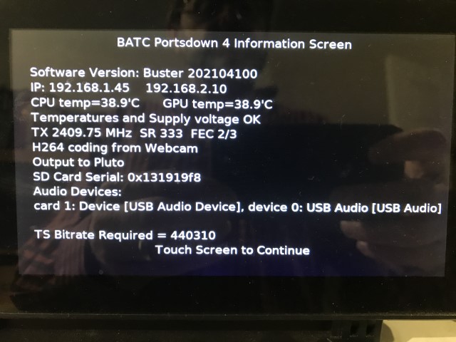

I have just rebuilt my system and although Portsdown works, I cannot get Langstone to start.
It goes through the very long motions (due to Pluto reset), the blue flash screen appears but goes back to Portsdown. Eventually, I suspected that there was an error message flash up before the reset but I could not read it in the time it was there. I then filmed it on my iphone and went through it frame by frame to discover it said Lang_tx.py failed to load. Check your sound card config.
There is a white ebay sound dongle plugged in which Langstone has worked with before and Portsdown info screen reports:
IMG_1502 (Small).jpg (77.8 KiB) Viewed 8515 times
So any ideas?

The error message remains visible on a standalone Langstone. It’s only when using with Portsdown that it disappears. I will see if I can add a delay.
You could try running the set_sound command from the Langstone directory to check and configure the sound device. However that message can occur for many reasons. It just means the Lang_Tx task failed to start.
See the wiki for other diagnostics.
https://wiki.microwavers.org.uk/Langsto ... iagnostics
Colin.

Thanks Colin,
I did the set sound command and it saw the dongle and said it had been set for Langstone.
I then did all the other tests such as Pluto and Mouse which it passed but still does not load into Langstone......
