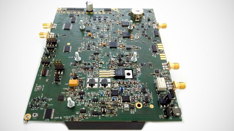

Hi Thomas
To give you an idea of the complexity (and potential cost) of a multi-band extension board, have a look at this device (the LimeRFE) developed for the LimeSDR, which does what you are describing. https://www.crowdsupply.com/lime-micro/limerfe. I do believe that it would work well with the Pluto.
I think that the LimeRFE is supported by some of the SDR programs, but shipping times of the CrowdSupply orders have been delayed by COVID.

I like the way a highly sophisticated PCB has great bolts sticking up through it holding it down to the heatsink. There is also a LMS companion PCB that extends coverage to 10 GHz. It's aimed at the Lime but no reason it would not work with other SDRs. Add these two together and you have LF to 3cm.G8GKQ wrote: ↑Wed Feb 03, 2021 12:41 pmHi Thomas
