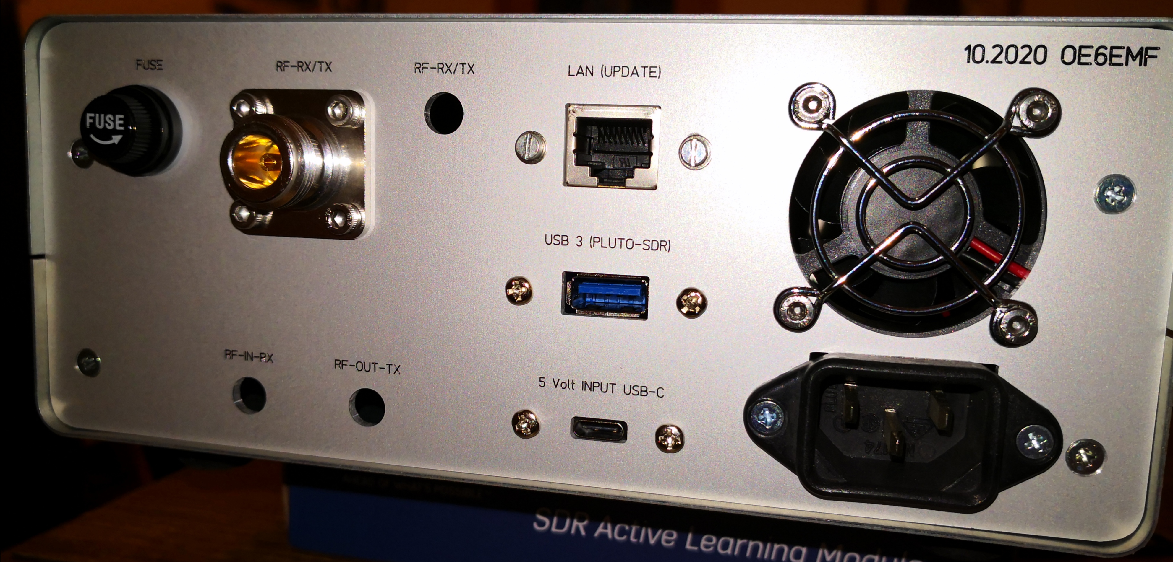

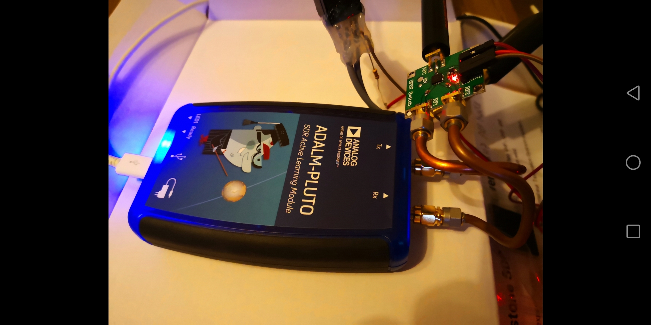

Post by OE6EMF » Sat Nov 14, 2020 8:49 pm
First pictures of the Langstone TRX backside!
73 de OE6EMF Thomas

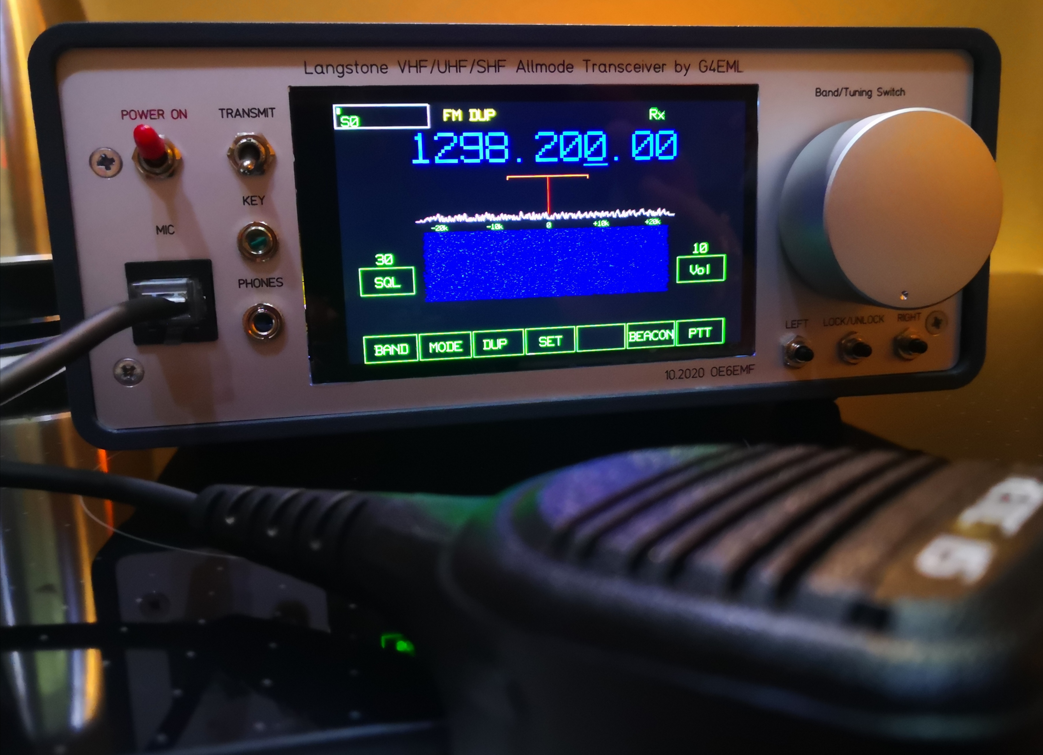

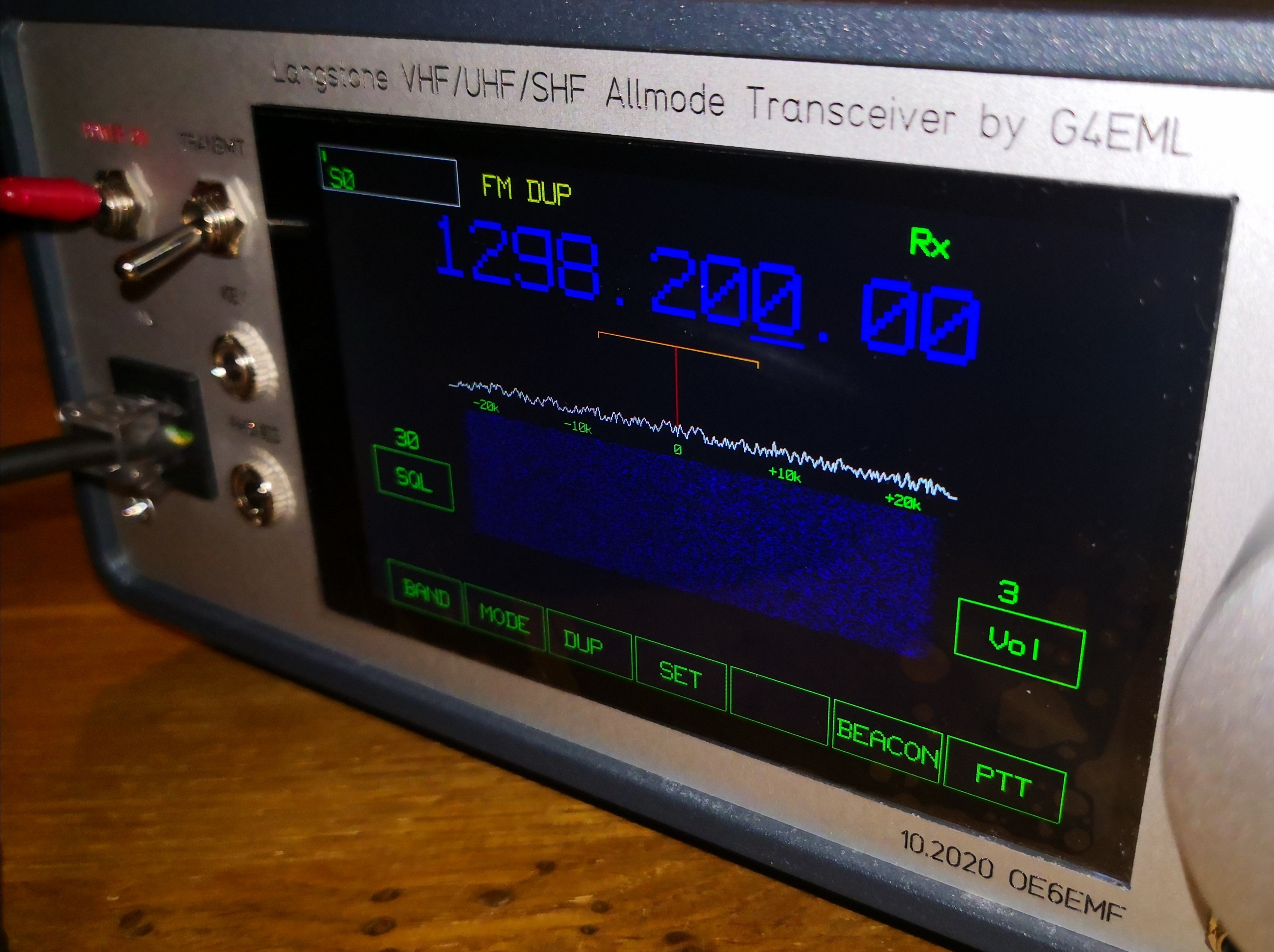

Post by OE6EMF » Sat Jan 23, 2021 9:36 pm
Now ready to use! ;)
73!
G4FKK
Posts: 161
Re: 4"Display

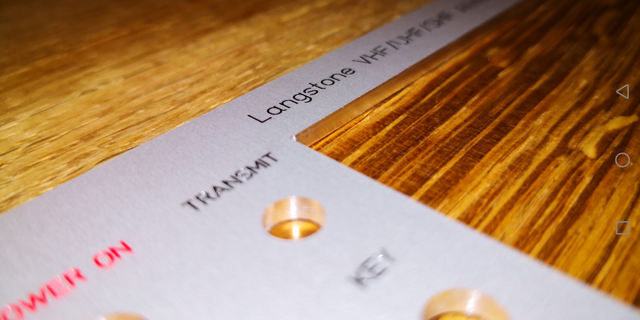

Post by G4FKK » Sun Jan 24, 2021 9:04 am
Very nice Thomas! Where did you get the panels made?
73, Martin - G4FKK
