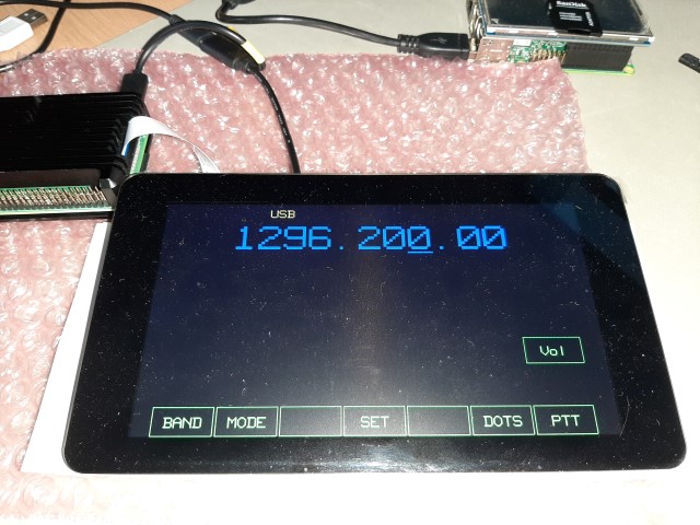

Update:
- Pluto: default IP adress, F5OEO SW for the Brave, 2nd CPU enabled and freq. extension
- First try yesterday: OM SD card Kingston CANVAS select Plus 16GB class 10
- New build on a SANDISK MICROSDHC 16GB ULTRA A1 class 10
Installed PD4 and afterwards Langstone, no luck
With this new build it is even worse, not working at all at start.
Langstone start up screen
20200819_090900 (Small).jpg (130.07 KiB) Viewed 9025 times
Another test: changing the Pluto and audio dongle USB leads, same behaviour.
If the problem relates to the Pluto I've to postpone further tests because I have to visit the OM and try his Pluto.
BTW: an earlier build with Langstone and PD A27 worked fine, I showed this version to the OM.

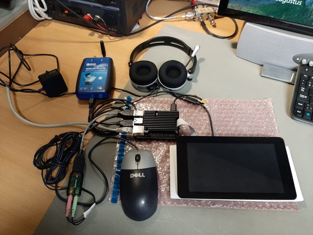

Please could you check the supply voltage between pins 4 and 6 of the GPIO connector, and also provide another wider photo of how you have plugged it all together?

Post by ON1AVO » Wed Aug 19, 2020 11:19 am
Dave,
The power supply is an original one from Raspberry 5.1V/3A, used with a USB Y-cable to power RPI4 & 7" screen.
Measured voltage in operation between p4 & p6: 4,985V (showing Langstone screen)
Next test: powering the 7" screen from the GPIO pins, measured voltage 5,070V, but no change in behaviour, freezed Langstone screen.
USB connections: USB2 sound dongle and Dell scroll mouse, USB3 Pluto
complete setup
complete setup
20200819_123818 (Small).jpg (152.91 KiB) Viewed 8978 times
Freddy
73 de ON1AVO
Freddy
