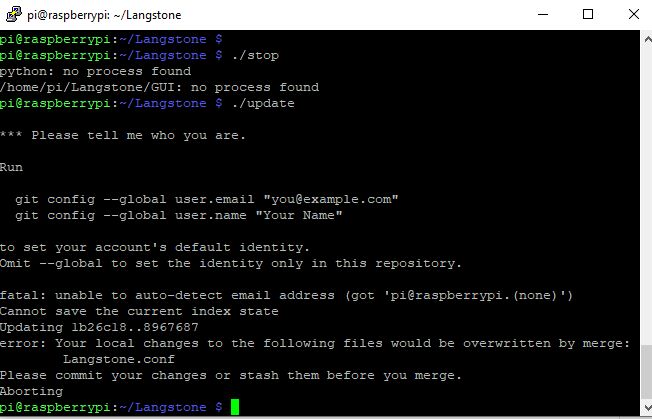

I attempted to update to the latest release today but failed.
Langstone error #2.jpg (48 KiB) Viewed 4954 times
Suggestions please!

Just delete the Langstone.conf file.
It will be recreated the first time you run the program.

Hi Clive
Sorry, I feel another wiki update coming on. Try this:
Code: Select all
cd /home/pi
# Stop Langstone if it is running
Langstone/stop
# Remove the old Langstone build
rm -rf Langstone
# Clone the latest version
git clone https://github.com/g4eml/Langstone.git
cd Langstone
# Build the c executable
./build
./run
This is more or less what the "Update Langstone" button does on the Portsdown A27 build.

Post by g4eml » Wed May 27, 2020 4:08 pm
I think Dave and I overlapped in replying.
Either solution should work.
Colin.

Thank you both.
I deleted the Langstone.conf file and the update completed.
