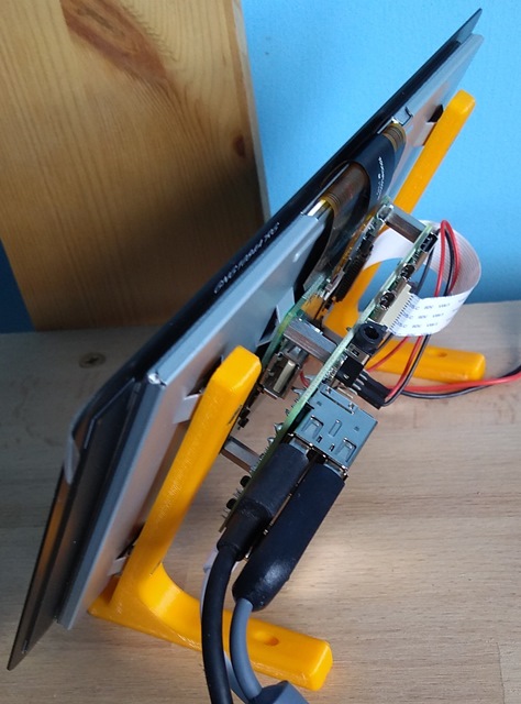

It's good to share, so here is my first little bit of this excellent project which I used yesterday on 4m for a two-way FM QSO across town. And my latest Pluto arrived today from Digikey (cheaper than Mouser and Farnell), already upgraded coverage and dual CPUs and tested across the shack on 5.7GHz. Better TXCO on the cards soon too.
Not wishing to damage the Pi screen or attached Rpi and not having finalised WHAT I want on the front panel yet (when I do I'll design something), some sort of stand was needed.
Print time is about 40 mins per leg, I used 20% fill, 0.2 layer height, no support and Qty 4 cheesehead 6x3mm screws.
I can't attach the .stl file but message me if you would like it.

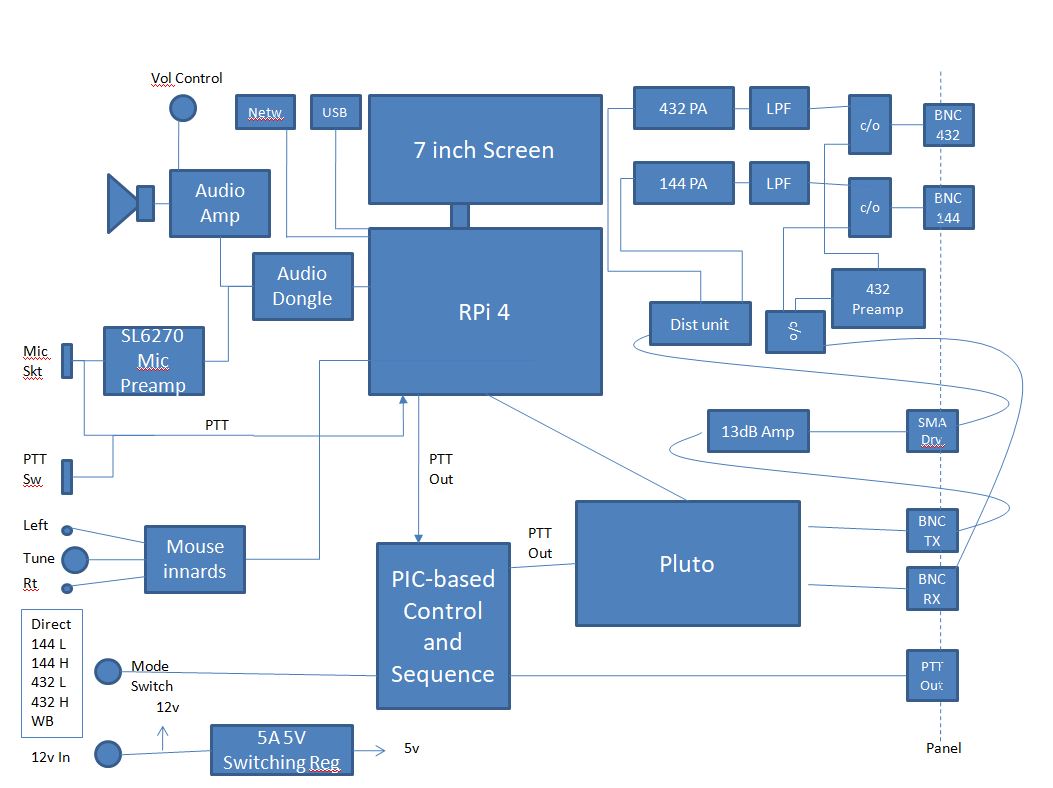

Hi
I always overcomplicate things, but here is a quick and dirty block diagram of my Langstone. I must admit that a few of the blocks are not yet installed, but basically it works, and has been on the air for local QSOs.
The 6 sockets shown on the right hand side are on the box side panel and connect back into the unit to the PAs and T/R switching. This means that it can replace my FT290 (3W o/p), replace my FT790 (and provide an increased 5W output), provide 10 mW of drive at 2.4 GHz, 5 mW of drive at 3.4 GHz and has potential for other uses.
Well done Colin!

Re: Langstone build thread - join in the fun!
Very nice. It will be interesting to compare with Lime RFE - when it arrives. For those that don't know, the LimeRFE is a filter / amplifier board with control based on an Atmega328 . It develops about 1W from HF to 13cms and a bit less on cms. It's part of LimeSDR family but not tied to it, it will work with any SDR including the Pluto. This, though not cheap, might be a good option for those not wanting to build their own front ends. It does not do 6cm, yet. It should work with the Langstone/Pluto with suitable glue software - the Atmega328 is apparently compatible with the Arduino Nano. I suppose there is no real reason Langstone can't work with the LimeSDR either as its GNURadio based.

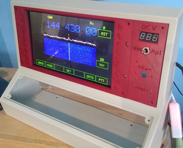

Nice sloping boxes arrived yesterday so printer busy making some 'stand up' feet as a first move.

Progress that does at least protect the glass edges of the RPi screen from inevitable damage. Pi camera added for video of the operator. RPi Camera 'clones' now only £4.99 delivered on eBay.
DC voltmeter module to show Vin, off or V RPi.
Remote LEDs to show what the RPI is doing (on, SD activity).
RPI standoff pillars needed shortening by 3mm to get the case back on.
Now thinking about the lower panel and I/O.
DC on/off and Indicator LED.
Be nice to have a rotary encoder option but it won't support 'two' mice plugged in at the same time (not surprising....).
External RJ45 socket for upgrading.
Will probably fit a Pluto inside (out of harms way in shack, WAT on the u-USB socket etc.).
D socket for band switching DATA and external PTT etc.
At least one USB for Lime SDR usage via Portsdown as and when.
DC in and out.
Mic and headphone sockets, speaker and volume.
Onward....
