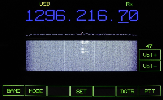

I've done a bit of work today geting a waterfall display to work.
Fairly minimal changes really...
Added 'Log Power FFT' block then 'file sink' block to the output of freq_xlating_fir_filter_xxx_0.
This is set to give 512 points fft across 44.1KHz spectrum, i did also tweak the width of the filter slightly for looks..!
The display code is inside LangstoneGUI.c, probably 40 lines or so.
Here is the display:
fft 44khz.jpg (134.57 KiB) Viewed 10908 times
span is 44.1KHz and tunes along with the receiver frequency.
Modified code is here so far:https://www.dropbox.com/sh/h4kmrf9kj5o6 ... xGW8a?dl=0
Edit: Spectrum graph is in there now too.

Hi Rob,
That looks encouraging, and sounds easier to do than I expected.
I doubt we have enough processing power to have a very wide spectrum display but even a few 10s of Khz is useful when looking for signals that may be slightly off frequency.
Colin.

I guess it depends on the resolution expected.
It will do the full 0.5MHz fine with 512 points but not much clarity of signals, i'm not quite sure how to manipulate the points in a big fft down to 512 pixels.
My sdr knowledge is minimal ;-)

Hi Rob,
I have just downloaded the waterfall mods and tried them on my Langstone.
I had to revert the IP address back to the default and reduce the buffer sizes. (they were deliberately set low to keep the latency down, but it sounds like that might have to be sacrificed if you want to run the Pluto remotely)
I initially had a problem with it stopping after one screenfull but that was because the file sink was writing to a regular file and not a pipe.
It is necessary for the pipe to be created before the file sink is started otherwise it creates a regular file, which then just grows larger and larger.
It should be possible to create the pipe in SSB_TRX.py but for now I have just added it to the ./run script.
It is obviously going to need a bit more fine tuning before it is ready to release but it looks very encouraging on first viewing.
I will have a closer look over the coming few days.
I have created a 'Waterfall' branch on github with the latest version. If you make any changes let me know or create a pull request and I will include them.
Thanks,
Colin.
