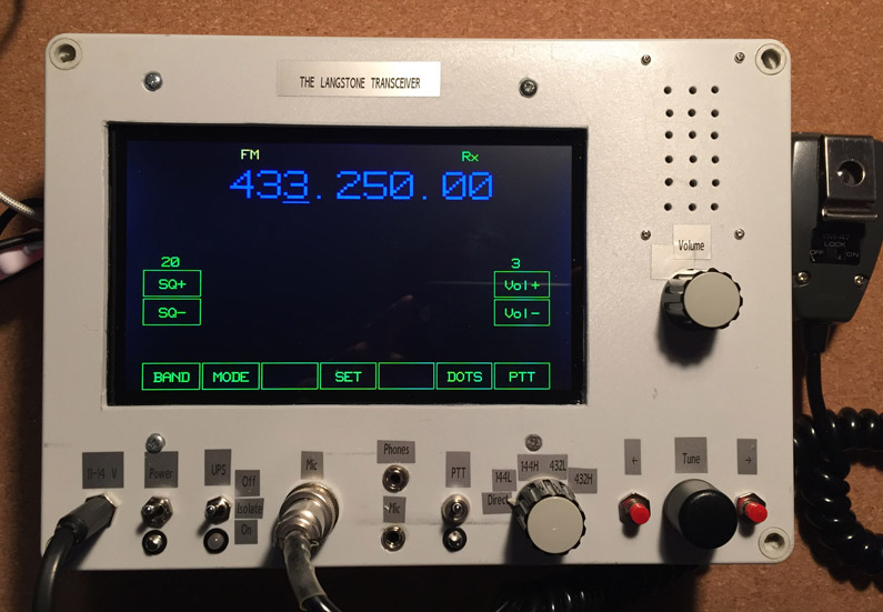

Please note that the system needs to be built with the exact hardware specified on the Wiki (if you want it to work first time) as it is in an early stage of development. A typical hardware implementation is shown below.

- Langstone Panel.jpg (130.43 KiB) Viewed 493112 times

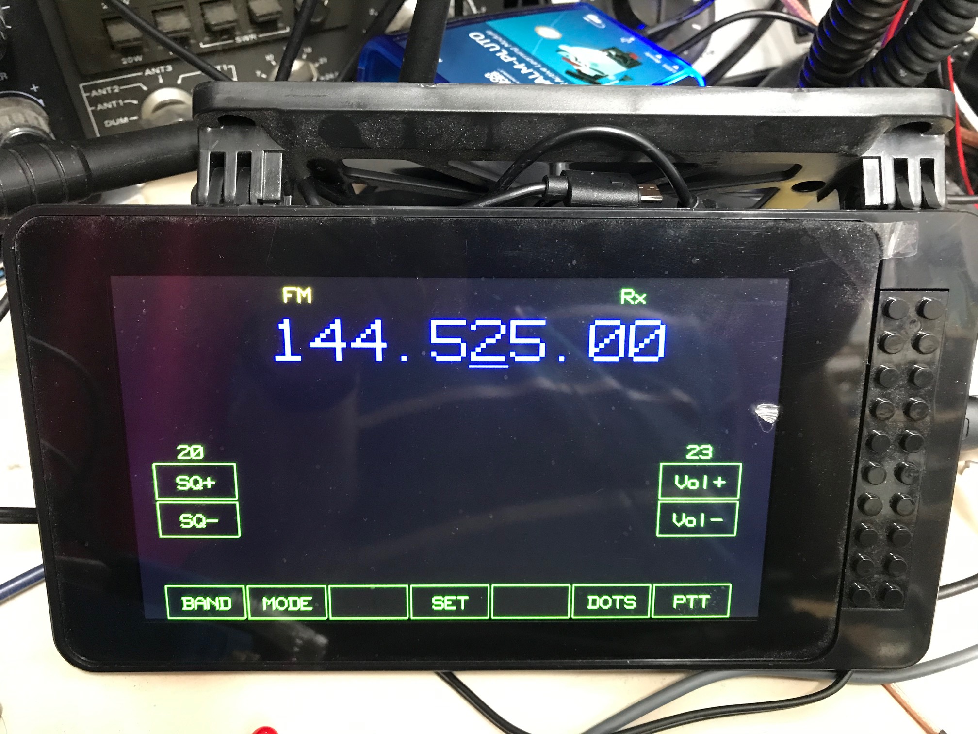

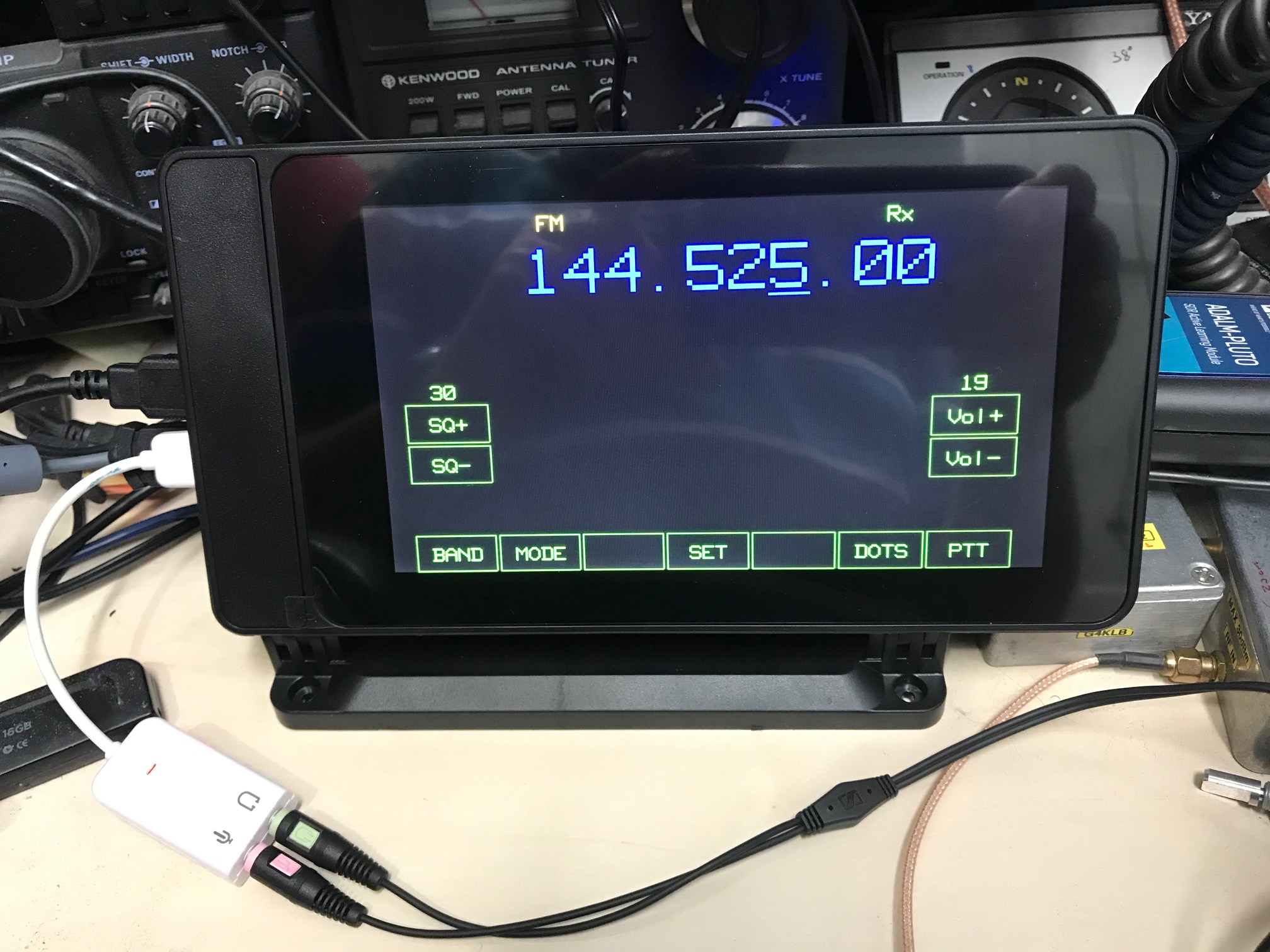

10 minuets after I attacked my Smarti pi case with a dremel to accommodate a RPi4 the Smarti pi Touch 2 turned up

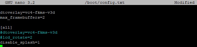

for this development case I had to switch the screen orientation with sudo nano /boot/config.txt and rem out lcd_rotate=2.
Don't know if that's the correct way to do it but it works.

Yes,
Commenting out lcd_rotate=2 is the correct way to do it.
I added that to the build script because my original case mounted the LCD upside down.
I will probably leave it there as it’s easier to comment it out than to have to remember the syntax and enter it.
Colin.

Hi Mike
In addition to Colin's list, I have added a multipin mic socket, so that I can use normal fist mics (with PTT switch) and also a manual PTT toggle switch. On the back (well actually the side) I have added an RJ45 socket and will add a USB socket in due course to plug in the MiniTiouner (don't get too excited yet!).
Good ideas. Any PCBs need making?
