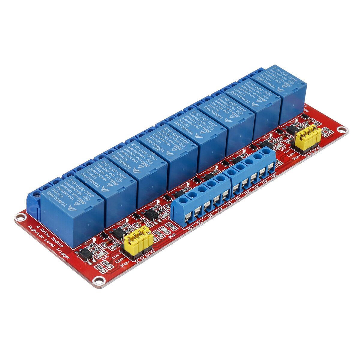

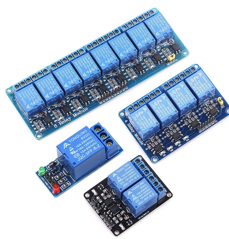

Here is the relay card I am using. Prices have risen considerably, they are now over £6, but it's still cheaper than making your own.
Works perfectly. I tested a few bands. A bit tedious as my relays are inverted, so I edited the config file after that to set them all to 255 rather than 0. Then went through band by band. All good. Checking the config file all OK. I find editing the config file is easier than going through the Gui but that's probably just me. The binary nature of the setting is quite intuitive. It might be worth having a sensible initial default setting,
However, I have noticed a problem with my mouse rotary encoder bounce so it was quite hard to set 0 or 1 consistently. I don't know if you are doing any de-bouncing but it might help. Might just be the encoder I have. Not sure if others have seen that..
Actually this might be better as it has logic sense jumpers. A little more expensive at £8.
