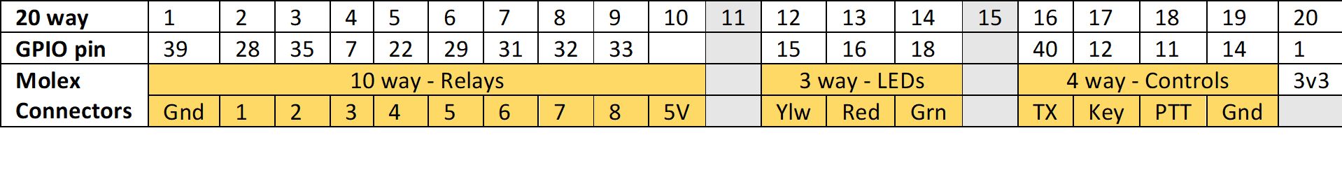

Hi Colin,
I don't know what the Portsdown uses but it would be useful if we could find out. I am not sure the Portsdown needs any of the earlier version pins in this configuration, save for the band relay switching which I would expect can be incorporated through the relay mapping. Don't need the IQ, don't need the Attenuator, Don't really need I2C. Might need the RF switch.
I actually did some wiring today and this is what I have: Not suggesting anyone does the same.
I added some LEDs to tell me stuff and put those on 15, 16 and 17. The idea was Green = RX (or maybe Squelch), Red = TX and Yellow an error state.
TX and RX can both be active at the same time in Duplex mode - e.g. for QO100. These LEDs are not really necessary with a gui but every project has to have flashing LEDs in it or it's not real electronics.
The additional relays are at the moment on 29, 31, 32 and 33. It's all wired with dupont jumpers so easy to move things about.
Another issue is sense. The cheap Ebay relays are active low not active high. That should not be a problem for the software but it might confuse things.
