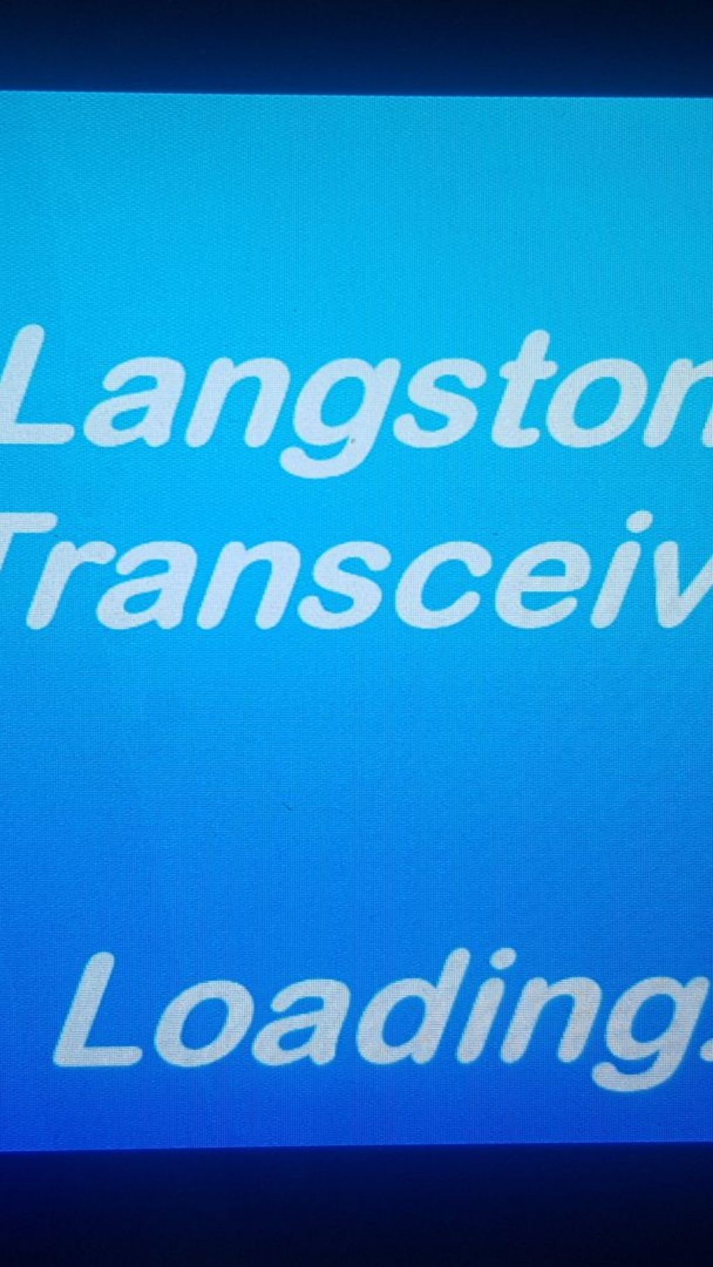

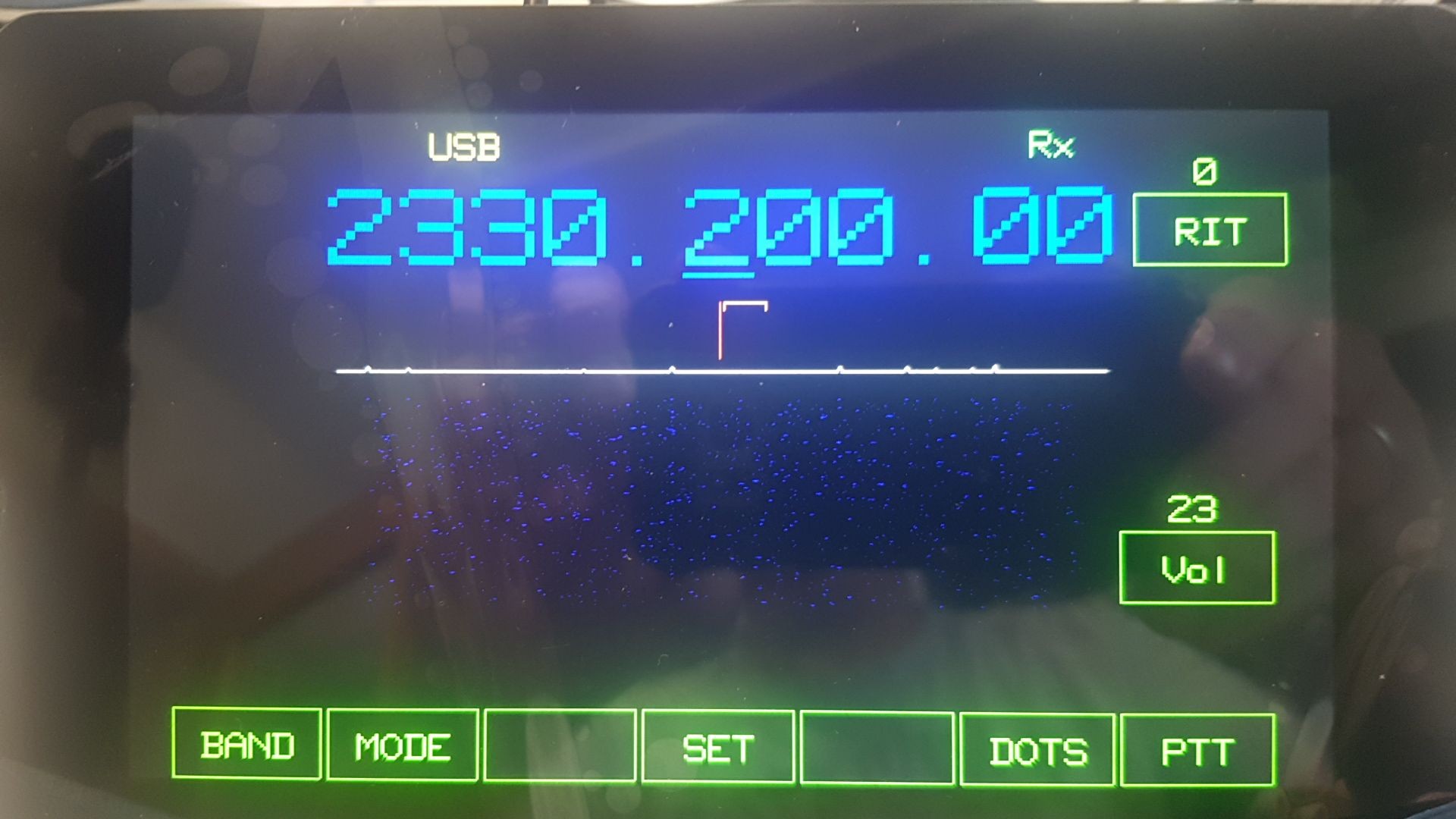

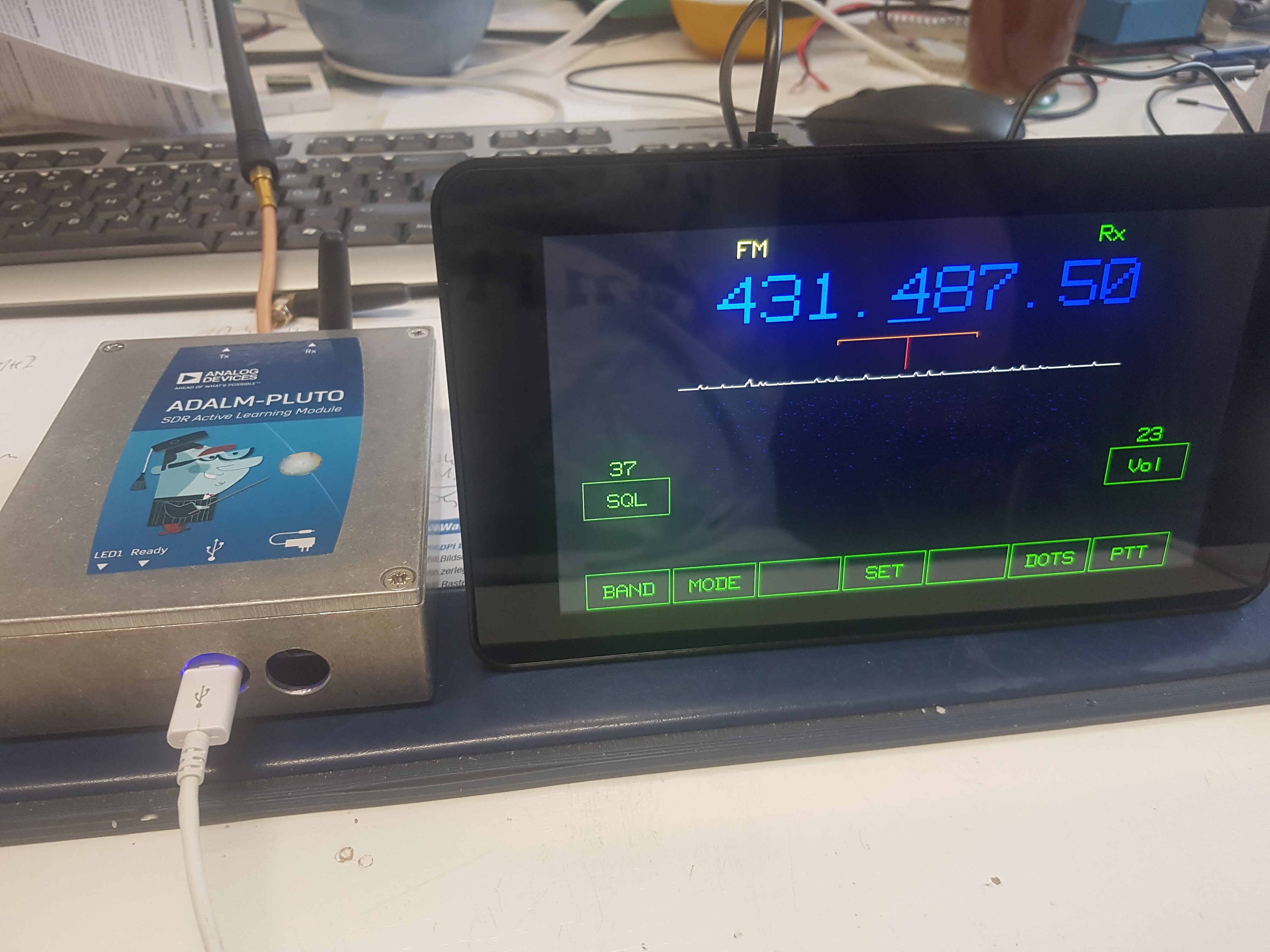

Hi at all,
got my raspi toys today. I still had a modified Pluto - in an aluminum housing ...
First attempts made ... Worked on 70cm over the local repeater.
73 Thomas DL5BCA
73 Thomas DL5BCA

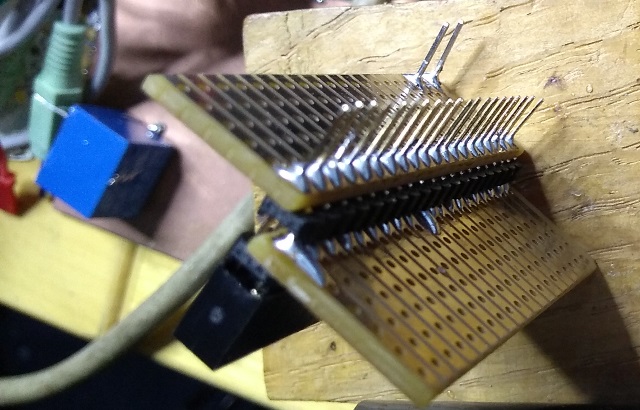

Finally, after all sorts of distractions, i'm back on finishing the packaging of my Portsdown/Langstone. I've been looking at the long pin socket on the back of the RPI since I started wondering how to deal with multiple connections to various pins now and in the future without shorting something out. I think this solves it, in part, by providing separation and multiplication. Each piece of veroboard only connects to one row of pins, after careful filing and relieving of the copper where its near the second row. The two lone pins are for the screen power. The rest may well be soldered and loomed.
A picture speaks a thousand words....
Gareth G4XAT
