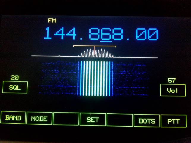

Re: Langstone Update
the new audio dongle arrived yesterday!
now it seems it's OK!
generated a 144.870 FM signal (1kHz tone, 3 kHz deviation) and received perfectly well: the tone is clear now.
attached a picture of the screen: is the waterfall correct?
Claudio
Hi Claudio,
That is good news.
Yes, the waterfall is correct for a constant FM tone.
Colin.
