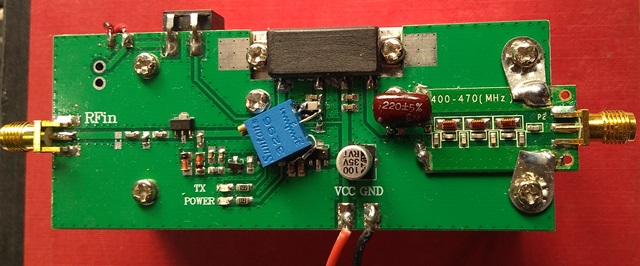

Spurred on by Jims article in CQ-TV about the small eBay 70cms amplifier, I bought one too. Seems close enough to identical.
As I would generally be using it portable, I wanted a stable bias voltage, so didn't use the input supply as that could be all over the place. Instead I tapped off the on-board 5 volt regulator via a multi-turn pot. My unit didn’t draw the same amps as Jims, but it did deliver a very handy 11 watts or so, with a bit less for DATV use. As it had no output filtering, I wondered if one of the cheap low pass filters from eBay might survive. Testing one showed it got slightly warm but no visible duress shown(i.e. no magic smoke) so I cut off the input SMA, used a decent silver mica coupling capacitor (the one fitted was a tiny 200pF ceramic) and removed solder resist as required to solder it down to the motherboard (LHS) and solder tabs under existing screws (RHS). A handy little unit to go lightweight /P with (DATV SOTA??) or to use with the Langstone.

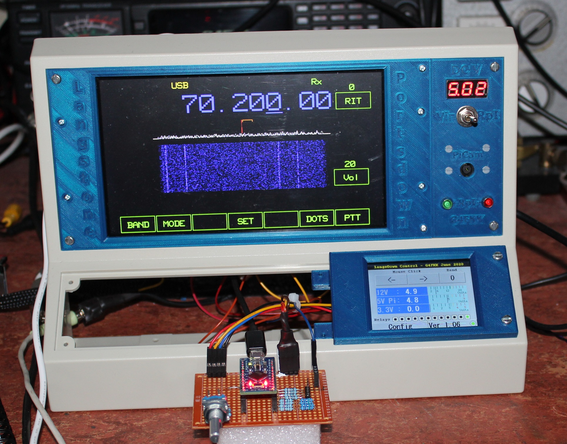

My trusty Langstone/Portsdown (LangsDown?), getting closer to having its lid fitted. With RadioGareth 3D printed panels and an Arduino Micro impersonating a mouse, monitoring/switching stuff and interfacing with a Nextion display...
I've also managed to GPS lock a 40MHz oscillator for the Pluto (not installed yet), and get an EPS32-CAM board working which may be fun with the Portsdown in due course. This lock-down business is certainly helping me knock a few items off the Project List
