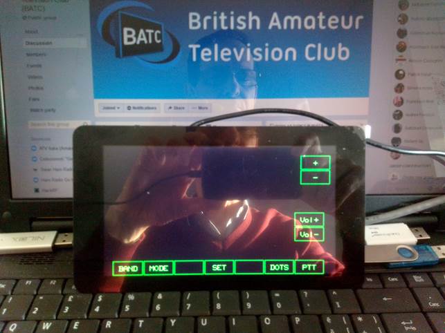

first step is done!
the screen is upside down but, at this stage, I can still rotate it! hahaha
my buttons look different and don't work...but I think it's because I have neither the pluto nor the dongle.

That display is normal.
It will not work unless you have both the Pluto and Sound dongle.
The extra buttons are because you do not have a mouse connected.
