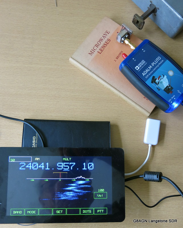

This morning I unearthed my very old WB 24GHz rig based on a Plessey Gunn diode module and fired that up.
As you can see in the photo, the Gunn is not very stable (as expected but OK for WB) and is low in frequency but at least I can now see a signal on Langstone at 24GHz. That's today's progress.
73 Barry, G8AGN

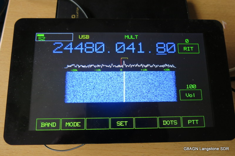

I have now tried receiving the second harmonic of an Elcom 1295 synthesiser running at 12.240GHz. This is normally used to provide a marker for 122,4 GHz for use with the VK3CV 122GHz transceiver boards. The frequency multiplication is done using a double diode mixer chip from an old SatTV LNB soldered across a piece of 141 semi-rigid coax.
As expected, this signal is very stable!
73 Barry, G8AGN
