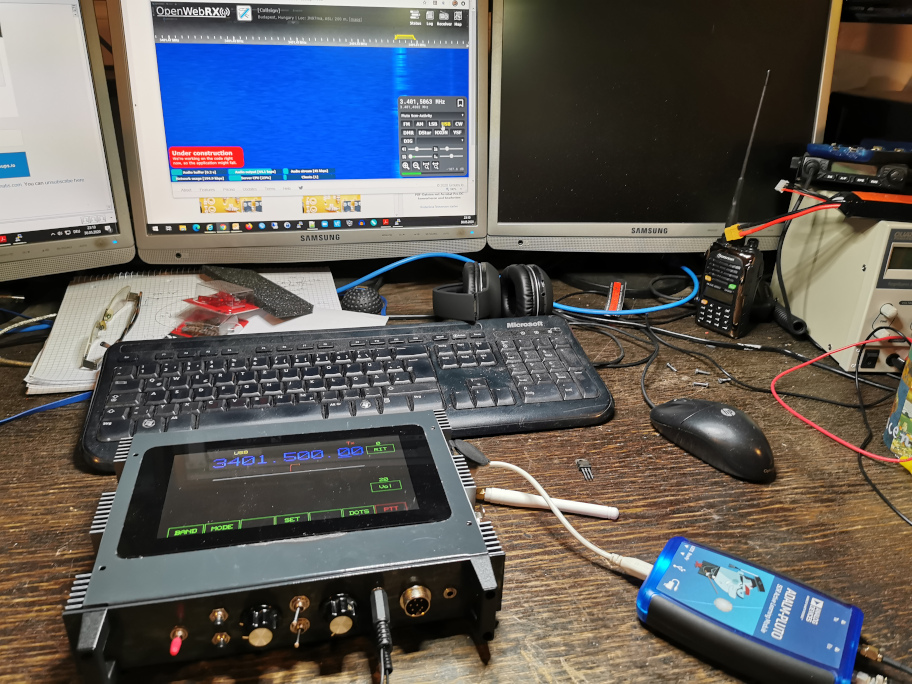

hi all,
just want to share my langstone which was pretty handy during the iaru microwave contest last weekend. ODX about 100km have been done with just 20mW of the amplified langstone. To get some impression of my setup i put some videos online as well.
Demo FM: https://www.youtube.com/watch?v=AF27mc3WW_k
Demo 9cm via OpenWebRX: https://www.youtube.com/watch?v=SDQ1G_KzqdA
Great project, congrats and very thankful to the creators of this project,

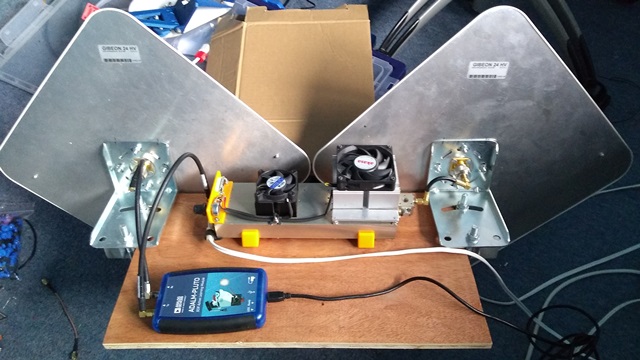

Post by radiogareth » Fri Jun 12, 2020 3:02 pm
A few years ago you could hardly have dreamed up this sort of capability. 10 Watts DATV or NB multimode on 5.7GHz via my pair of 22.3dBi flat-plates originally bought for FM-TV on the band. Pluto has had a TXCO change.
There are now TWO 'best things to do with a RPI' - the Portsdown and the Langstone. Thanks Dave and Colin :-)
