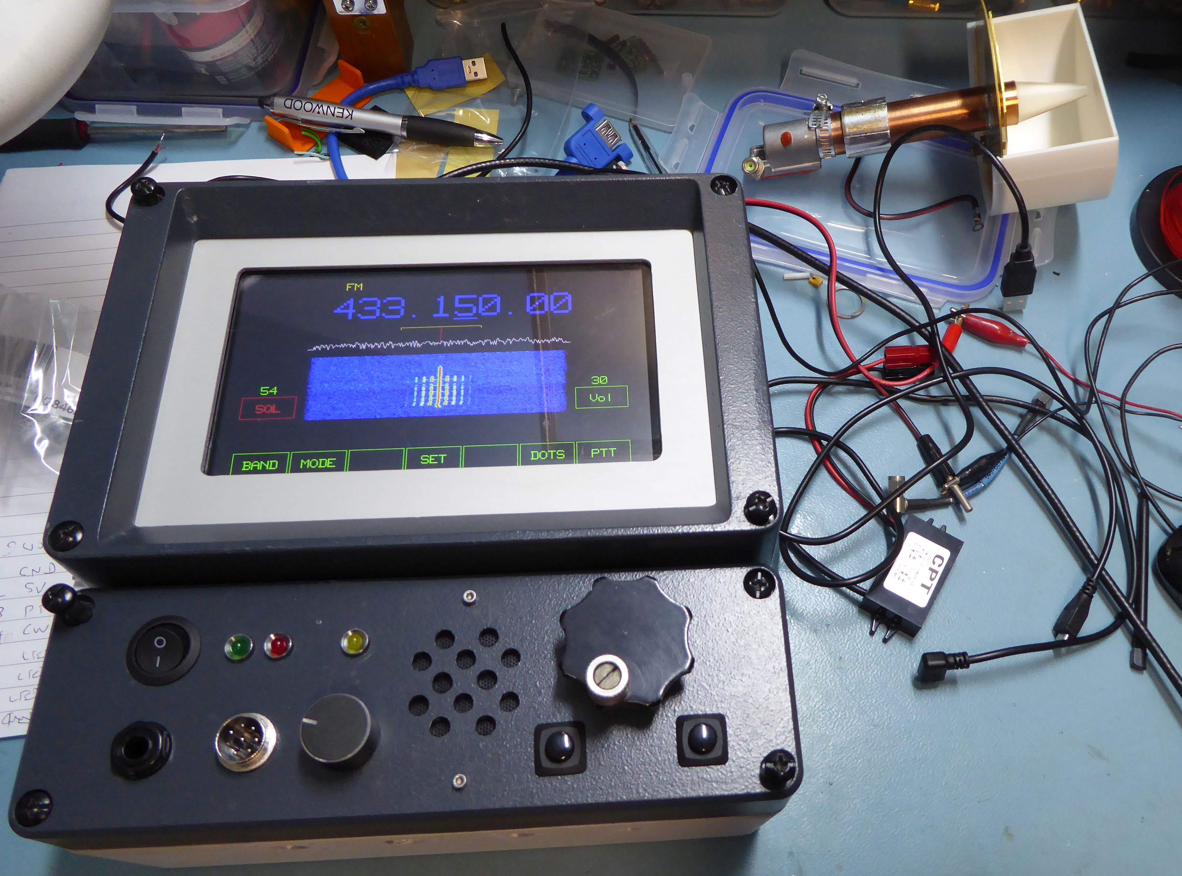

This is what I used. An old case
I suppose it is about 10x12x5 and a squeeze. If you look on my web page projects section, you might find the PCB I made for this useful. You will have to order your own though. http://www.mike-willis.com/projects.html
