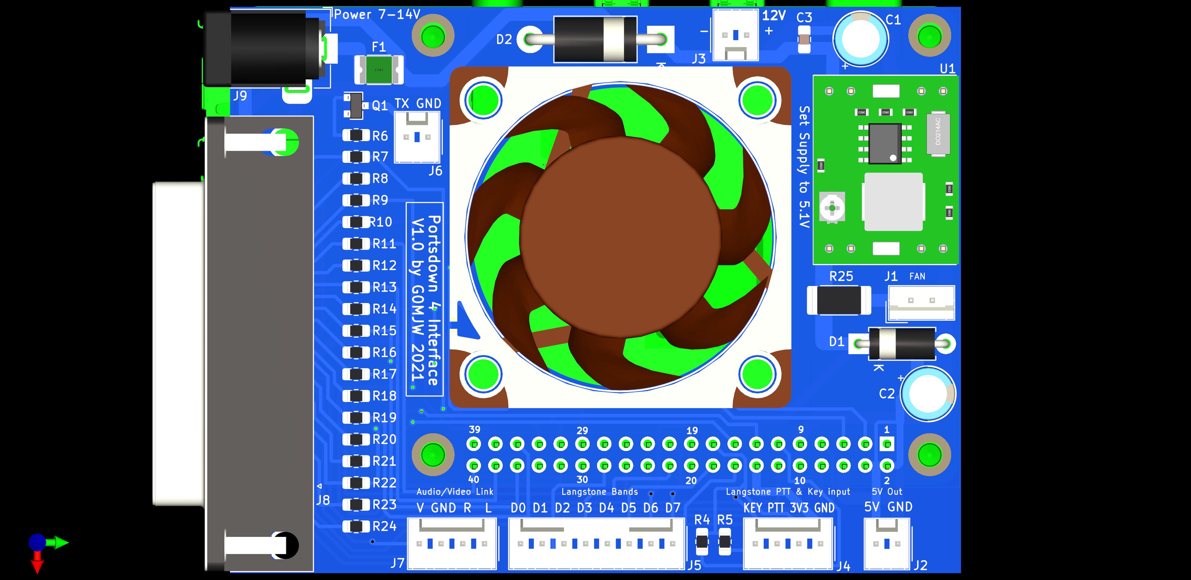

Any interest in a GPIO adapter for Portsdown 4 and/or Langstone? The idea is to mike wiring Dave's 25 pin connector easy while also allowing for Lanstone bands. Not at the same time as there are some port clashes. Also has an open collector PTT switch.
- P4GPIO.jpg (519.72 KiB) Viewed 237128 times
Hi Mike,
the 25 pin connector on PCB for external connection is a good idea!
this PCB will be available from the BATC shop?

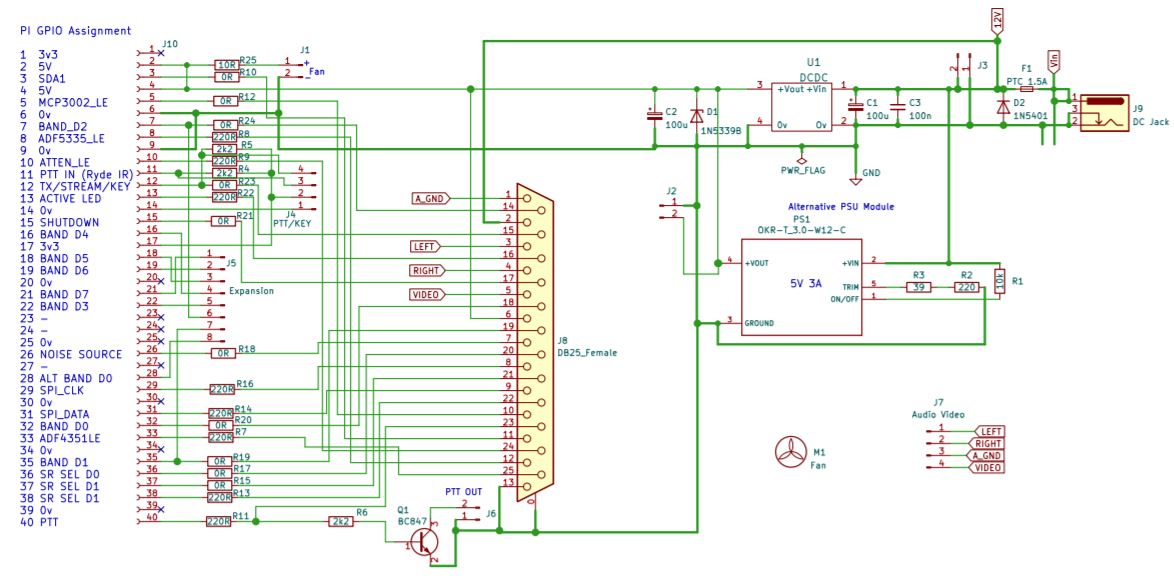

It is one of my projects, not a BATC one. I won't be distributing PCBs and I expect the demand would be low for the shop given the specialist nature and there are already other several Portsdown/Ryde GPIO boards available, so it might just be a case of making the gerbers available. Sadly, it would cost more for me to post a PCB to the EU than it would you to order a new set of 5 from China direct.
Before that it needs to be tested. Schematic:
