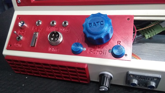

Thanks for the Beacon update, I found the entering process very quick and easy.
I'm on my final assembly and testing (until the next time....) and I have put a nice little microswitch on my front panel in parallel with the 3.5mm CW KEY socket.
Would it be possible to have the morse key operate as PTT too? At the moment I have to press PTT and then I can send CW. Or am I missing something?
Maybe (in the future) could it have a sub-menu to chose (I think these are the terms) Full break-in and semi-break-in? (CW VOX?)
I have also included a front panel mic socket which works as intended, ie Langstone goes to TX when MIC is pressed. Could the PTT go RED when TX is indicated. Some sort of VOX operation may be wanted for headset operators, although I personally don't use it so not on my wish-list as such.
Lock function is great too.
Pic shows my front panel, touch-screen is above.
2020-10-28 09.37.31.jpg (86.99 KiB) Viewed 127527 times

Hi Gareth,
Adding semi break-in for CW should be possible. Probably no updates for a while though as I am working on another project at the moment.
The onscreen PTT goes red to indicate the latched PTT is active. It would be confusing if it also responded to the hardware PTT. There is already the red TX indicator to show when it it transmitting.
VOX is probably not going to be added.
Colin.
