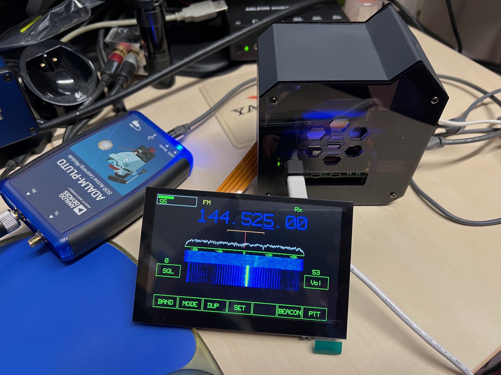

Testing Langstone on my Raspberry Pi 5.
First with the official 7 inch screen.
7 inch.jpg (880.63 KiB) Viewed 9921 times

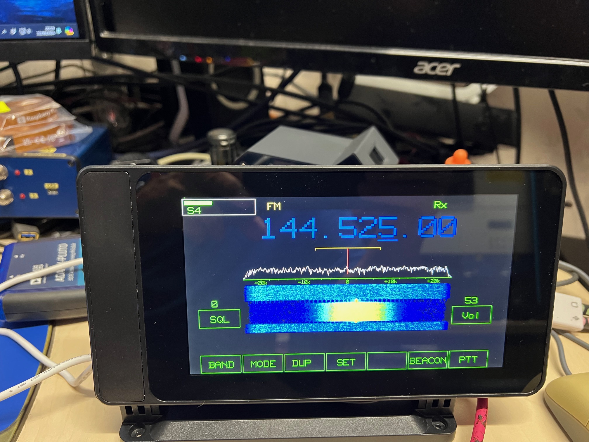

And then with the 5 inch ones I use.
No changes to rotation or touch were required.
5" DSI Capacitive Touch Display for Raspberry Pi (800×480)
Waveshare
SKU: WAV-18396
I bought mine from The Pi Hut
5 inch.jpg (813.36 KiB) Viewed 9921 times
These are not the supported screens, so may not always work :oops:
