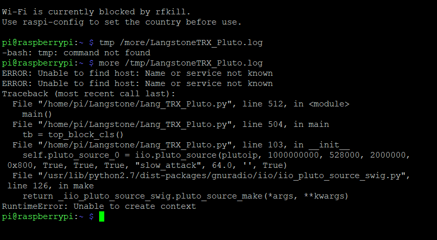

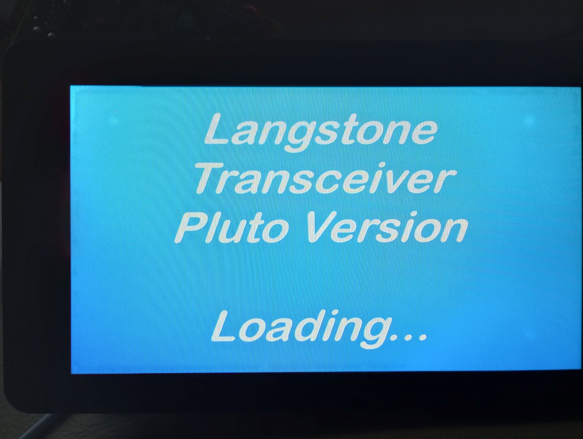

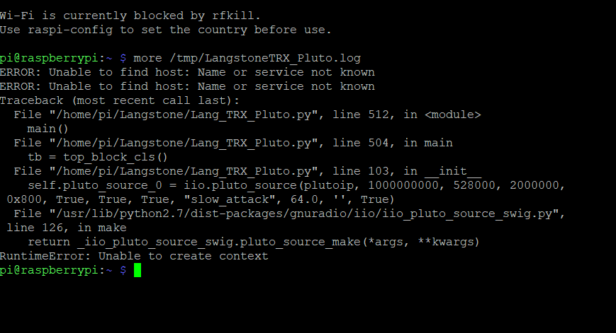

I went for an install, no longer get the error message, but it jut sits on the 'Langstone Transceiver' screen. Oh and now I've a red LED active in the USB audio interface which I didn't have before so I guess that's functioning. In the log I get this host error. I'm afraid the Raspberry Pi environment is totally alien to me....

That is saying it can't find the Pluto device.
The default setting assumes the Pluto is called pluto.local and is at 192.168.2.1
Either the Pluto is not working correctly or it has the wrong name.
If you have changed the Pluto name or IP address then you will need to set it using the set_pluto command.
If the Pluto has the default settings then you could try connecting it to a different USB port.
Also the power supply voltage can be critical. The Pluto doesn't seem to like anything above 5V.

I've had COVID so only just picked this up again. Anyway, tried second Pluto, Schottky diode in Pluto positive rail, different power supply, fresh install using a new SD card but still no cigar.
I do now get this in the log rather than 'cannot find host' or similar.

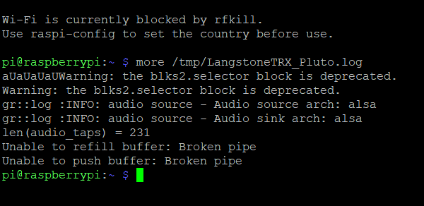

G0ILO
Posts: 10
Joined: Sun Apr 28, 2024 10:56 am
Re: error on Langstone
Post by G0ILO » Mon May 06, 2024 10:32 am
Actually above was on my second Pluto. Attached is my original one and the log I'm receiving now.

Post by g4eml » Mon May 06, 2024 8:00 pm
Those errors are still saying it cannot see the Pluto.

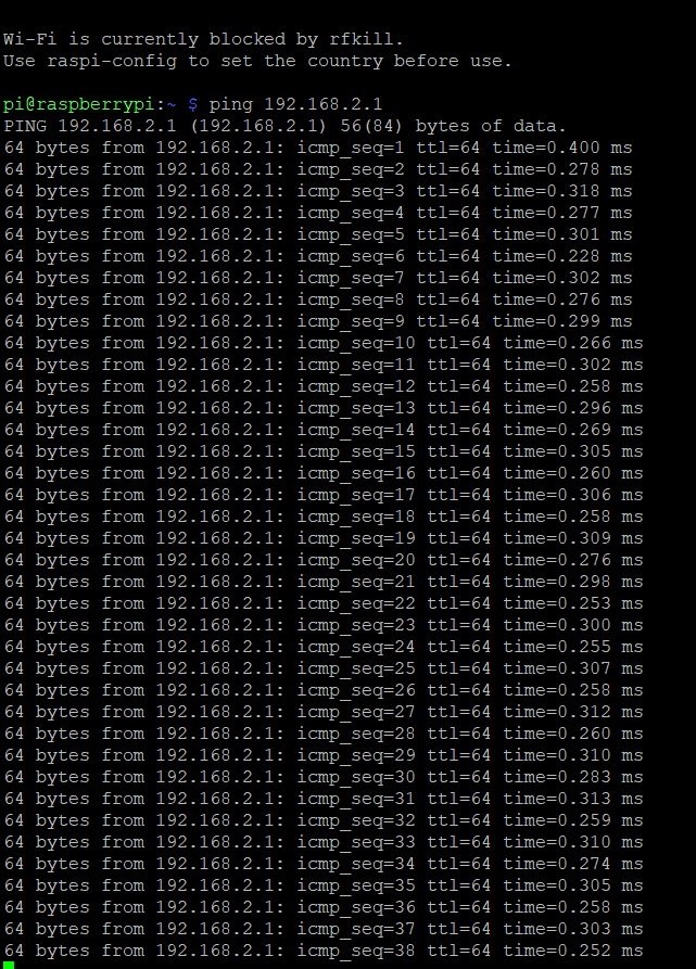

You could try the following.
Log in using SSH and try pinging the Pluto to check it is responding.
Code: Select all
ping 192.168.2.1
You should see multiple 64 byte messages confirming the connection.

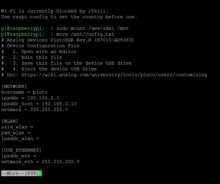

If that fails then check the configuration of the Pluto
Code: Select all
sudo mount /dev/sda1 /mnt
more /mnt/config.txt
This should show the Pluto config file.
In the [NETWORK] section it should read
hostname = pluto
ipaddr = 192.168.2.1
ipaddr_host = 192.168.2.10
netmask = 255.255.255.0

Hi Colin,
Just done as you suggested and I'm assuming all is correct?

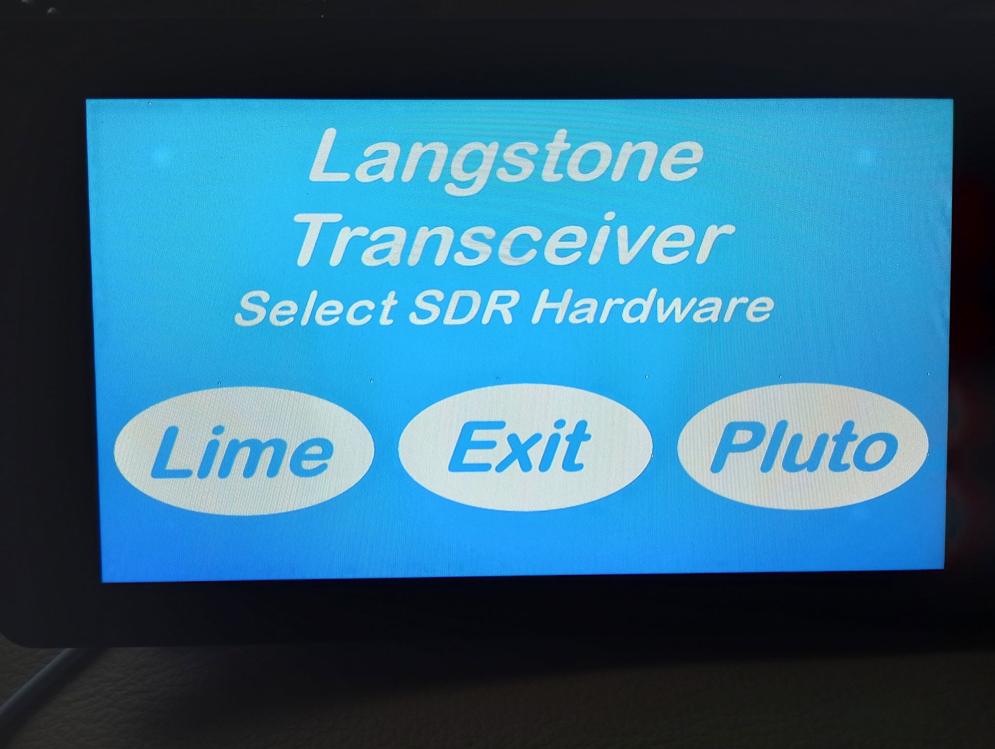

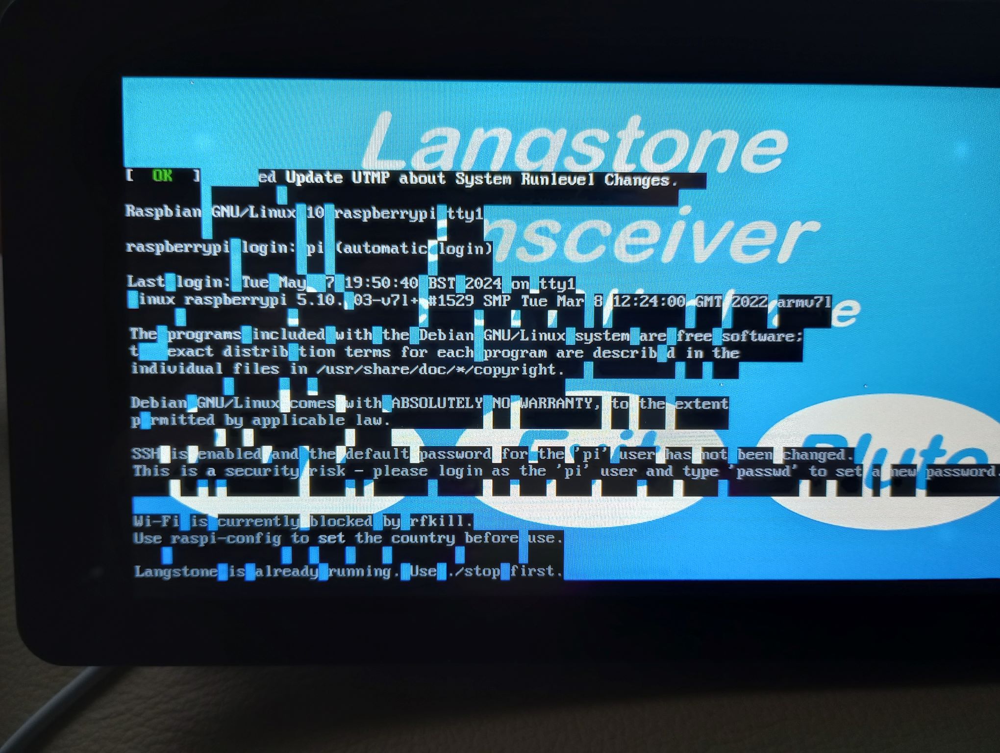

I did go for another install but took the option to select the hardware just to see what gives
opening screen
After selecting Pluto
After 10 seconds or so back to this screen
Then it'll go all screwy if I select Pluto again.
