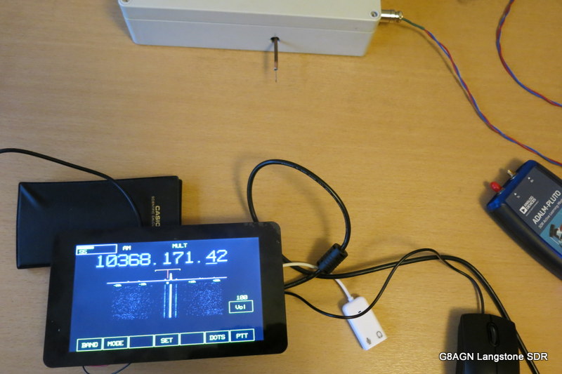

I ended up measuring the frequency of the TCXO itself using a scope probe just touching pin 3 on the TCXO and using a counter with 10MHz external reference from a Chinese GPSDO "standard". I then transferred this measured frequency to the Pluto using Putty and the commands
fw_setenv xo_correction 39999525 and then reboot. The new TCXO value then shows up in the config.txt file.
My measured TCXO frequency is still not quite correct but much closer and on 10GHz my error is now around 20kHz, I have a better TCXO on order so will fit that when it arrives and repeat the procedure.
The Pluto is very sensitive on 10GHz even without an antenna so due to pickup through the plastic case as you suggested earlier.
I like the ease of tuning with the mouse.
What is the amplitude range of the spectrum display?
73 Barry, G8AGN
73 Barry, G8AGN

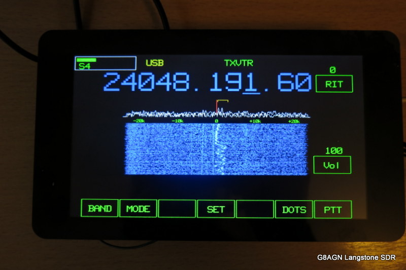

I have mine receiving on 24GHz using a paper clip as the antenna. The signal is not very stable due to the 25ppm TCXO but still very impressive. I'm using the 7th harmonic of 3435.46 MHz as the Tx signal.
73 Barry, G8AGN
73 Barry, G8AGN

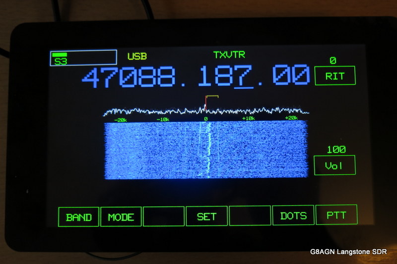

I'm not sure I believe this but have no way of checking
11th harmonic of 4280.75
73 Barry G8AGN
73 Barry G8AGN

I doubt that's a real reception. Interesting if it is though.

False alarm as I hadn't set the offsets to 0 and x5 sorry.
I cannot see my marker on 24 or 47 after all -- too weak.
73 Barry
