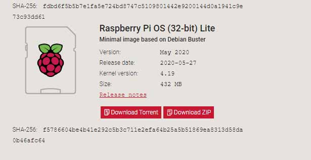

Re: Latest build: after reboot frozen screen
Hi Freddy,
you have taken the OS (see attachment) as the basis for the installation.
If this does not work despite a correct installation, then the best thing to do is to use a new SD card.
For me it works without any problems.
Thomas,
Yes this is the version I use to build the SD card.
I tried already 3 different 16GB class 10 SD cards of different vendors: Sandisk, Kingston and Transcend.
73 Freddy
