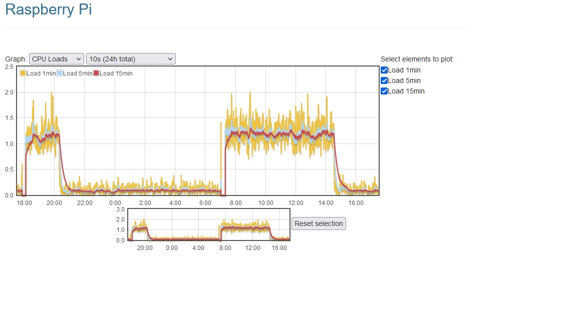

Another question, I am monitoring the langstone raspberry testbed with rpi monitor. There were two reason motivating this : a)insure that the active heatsink I put on the board was ok b)understand how stable are the langstone processes
When doing portable, it is common to get freezed by the wind or burnt by the sun, the equipments, mainly the final PA are also heating the system so I need to have some reliabilty ... With the actual heatsink, I a seeing a 35°C when the room is at 20°C so it is fine
I frequently find the langstone setup frozen after a hour or a couple of hours (over night) and am wondering why. See the load profile on my rpi testbed.
Nothing special, RPI4B4Go, 64Go ultra from Sandisk, build as shown on github, 7" screen on my testbed (5,5DFR on my future portable setup) , generic mouse , generic sound adapter, pluto+
Are there any log traces I could have a look in to understand which process (at least the GUI but it could be a consequence of other threads)
Kind regards
Jean-Marc

- load monitoring on Langstone7 rpi4B4
- Langstone7.jpg (94.9 KiB) Viewed 16963 times

All of the log files are in the /tmp/ directory.
However they don't contain much, so are unlikely to be of much help.
The heaviest load on the processor is the .py file which runs the GNU Radio flowgraph.
Colin.
