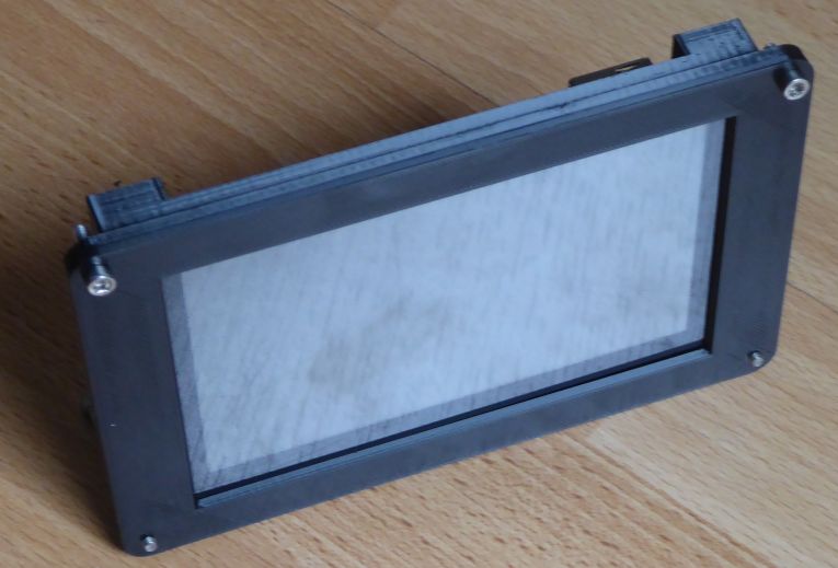

The screen arrived, it works but only after a config change as explained earlier. I wanted a mount for it and finding nothing suitable online I have done a 3D printed model here - https://www.thingiverse.com/thing:5019838 I don't have capacity to make these so please don't ask.
