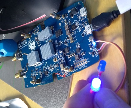

Post by radiogareth » Mon Oct 26, 2020 12:19 pm
With my pluto being mounted inside the whole box, I wanted to extend the Activity/Ready LEDs to the front panel so I can see what the Pluto is actually doing (or not if something locks up).
The diagram is here https://wiki.analog.com/_media/universi ... c_revb.pdf showing low side drivers as might be expected. The LEDs on the PCB were tried with some 5mm blue conventional ones across and as both still lit up fine I went with simple wire extensions to my front panel. They were easy enough to solder to with a conventional iron, unlike the RPi which was a real job!

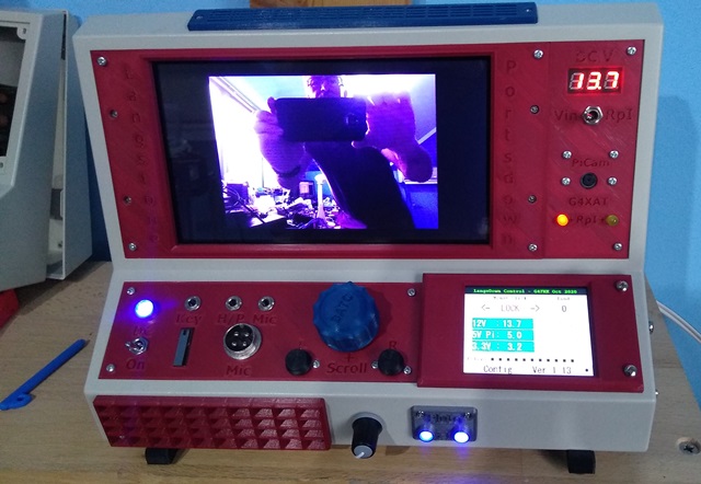

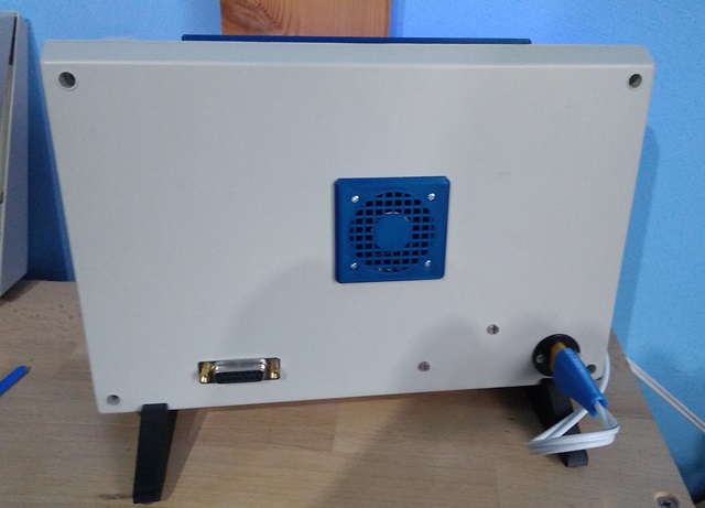

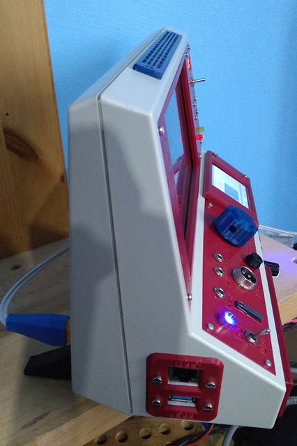

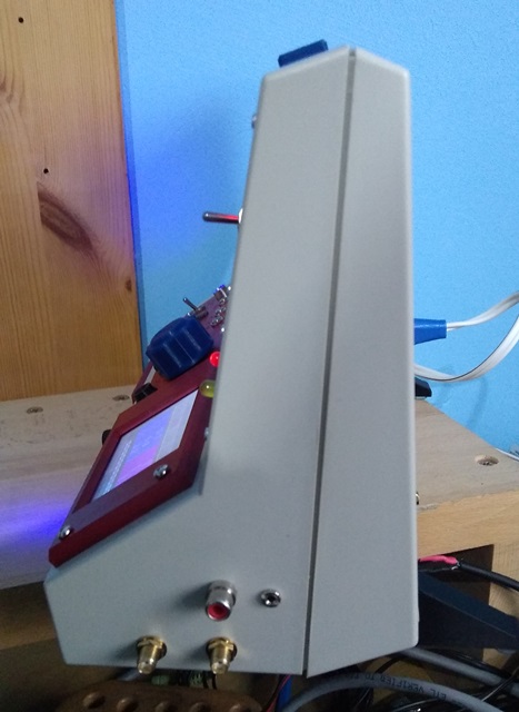

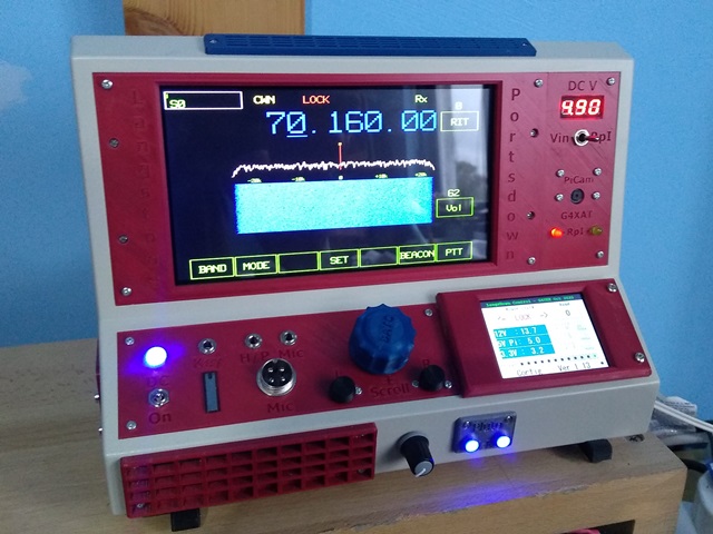

Post by radiogareth » Fri Oct 30, 2020 3:53 pm
Well the back is on.....for a few days. Still got the external control socket to wire up once the control expansion board arrives.
Very pleased with the outcome and functionality.
Huge thanks to those who have written and contributed to the software suite, Dave, Colin, Heather, Martin and others. All I've done is package it....
Gareth G4XAT
