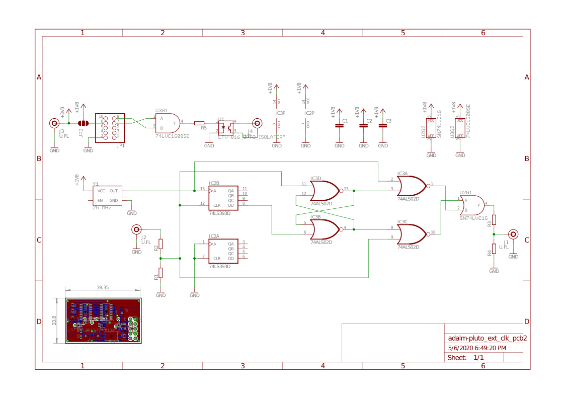

Post by YL3AKC » Tue May 26, 2020 5:06 am
This is under construction right now. It have internal TCXO, ext osc in and PTT optocoupler with Evariste (F5OEO) GPIO pin logic.
When no signal on ext osc, circuit work from internal tcxo.
When ext appiled it automatically switch to ext osc.
Auto switching between tcxo and ext osc.
When GPIO 0 and 1 is on XOR and optocoupler is off.
When GPIO 0 is on, optocoupler activates.
PCB have 10 pin header with connected GPIO and optional 1.1V input.
Ext supply (1.8V), Ext osc in, clock out and PTT out are on UF.L connectors on PCB.
there is solderpad jumper to select supply source.
ICs are rated to 40 MHz @ 1.1V supply.
TCXO is rated to 1.8V supply.
There is place for mounting screw in future.
I am waiting for components from farnell to test this PCB.
Maybe later this project will go to tindie.
I am planning to use external low phase noise 25 MHZ PLL clock source together with QO-100 LNB.
PS: don't look on component names, they are artefacts form quick and dirty schematic drawing.
