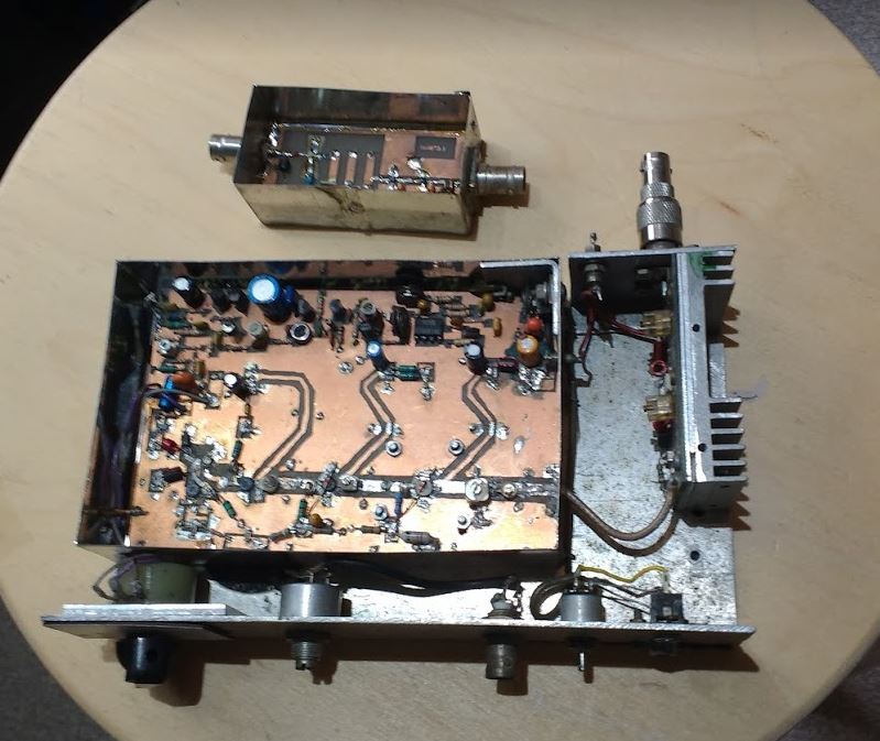

Can any member identify these PCB,s ?
Possibly Wood and Douglas ? ;)

Re: Can any member identify these PCB,s ?
Post by G3GJA » Wed Jul 24, 2019 6:02 pm
That's a Solent 23cm analogue FM ATV transmitter.
Capable of 1w or a bit more with tweaking. Free running VCO at 23cm but synthesizers were available, the original multi-channel using a CB radio sysnth chip and the other Worthing offering was based on a Plessey SP5055 and gave a single channel from a xtal multiplied by 256.
Originally offered as a kit by G8CMQ (?) in the 80s, it was taken on by the Worthing ATV Repeater group so it's also known as a 'Worthing'
Your PCB may be home made as most I saw were tinned, not bare copper
Looks like someone as added a PA. The usual method was to add a Mitsubishi M57762 brick and that could give 18 to 20w out.
If it has a M57762 its worth hanging on to as it can produce 4w of DATV with shoulders more than -40 dBc.
The small box may be a preamp for 23cm but I don't recognise it.
Post by G4GUG » Thu Jul 25, 2019 4:33 am
Thanks Clive.
I have responded with an email to you.
Thanks identifying the pcb's.
73 Mike G4GUG.
Stroud Gloucestershire.
Post by M0SKM » Thu Jul 25, 2019 5:55 am
If any use to you there is a Solent schematic in the BATC Wiki.
https://wiki.batc.org.uk/Solent_ATV_units
Post by G7JTT » Thu Jul 25, 2019 10:14 am
The preamp looks familiar to something I knocked up for my Solent back in the day will look when I get home and see if I have any info.
All best John G7JTT
Post by G4GUG » Fri Aug 09, 2019 12:41 pm
Gentlemen,Thanks for replies,
With schematic now downloaded
Feel more confident about applying a power supply.
Sorry for delay in responding.
