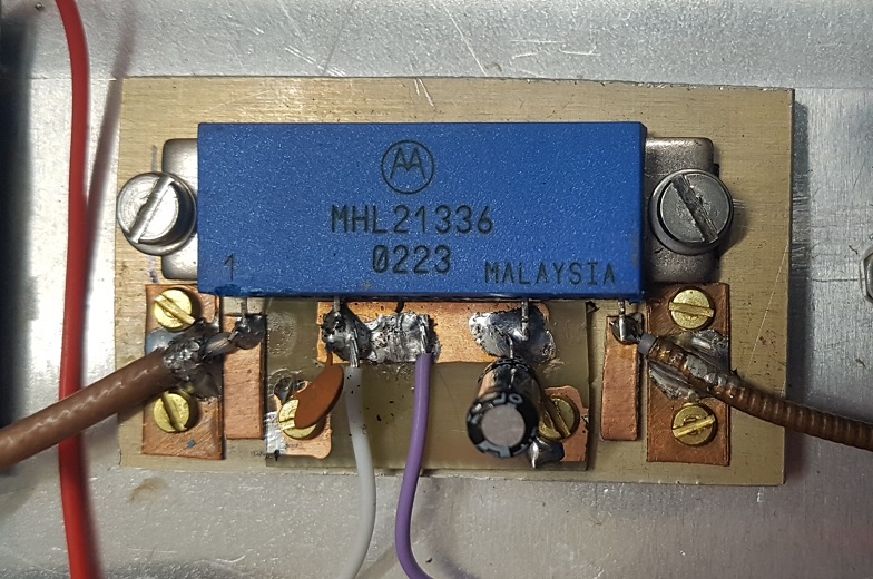

These little MHL21336 amp modules are quite cheap (were ~£8 but now ~£15), can give 200mW at 2.4GHz with a bit of fiddling.
Maybe not the answer you were hoping for but is an option, they do run off 28v though.
Here's a photo of one I cobbled together a while back but gives a nice clean 100mW DATV for my QO100 Tx.
The strips of pcb on the input/output act as matching to improve things, a good 25dB gain if I remember correctly.
