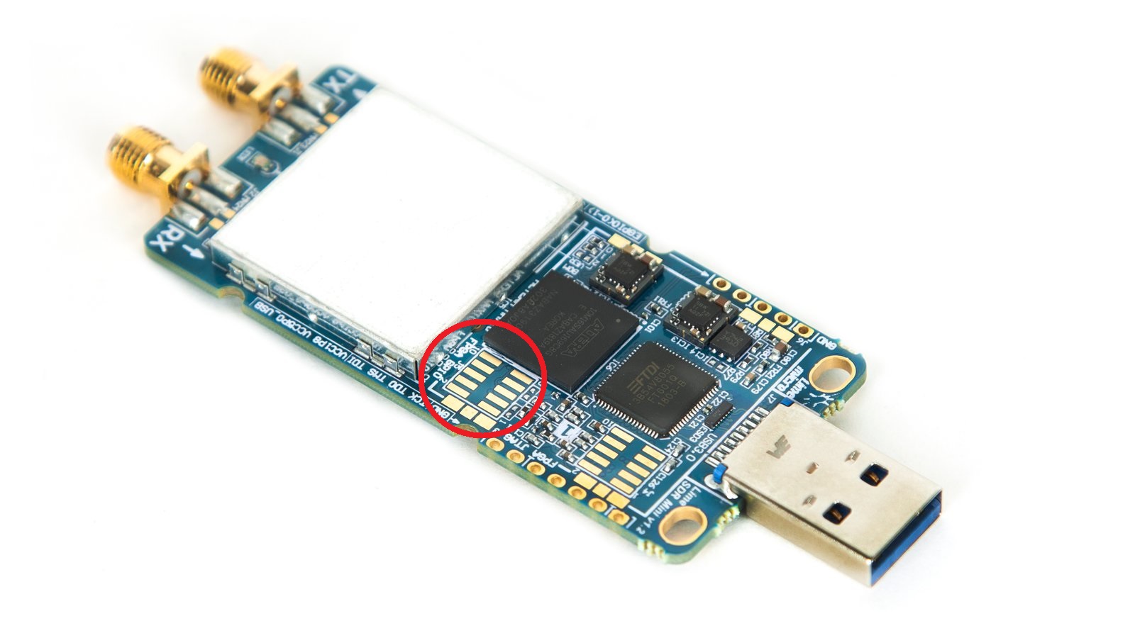

I am looking for a suitable SMD female connector to mate J5.
NOTE that the space between pins 9 and 10 and the Altera chip is VERY small!
thanks!

That PCB layout is intended for a 1.27mm pitch pin header such as the Harwin M50-3600542

thanks Colin!
