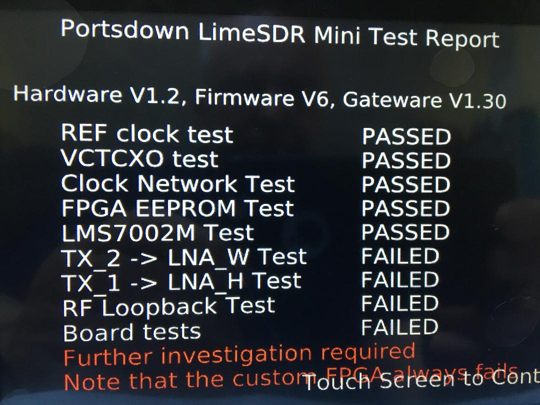

Hi could anyone please advise on the fails Im seeing on the lime sdr mini test report
All seemed to function but running the report showed the attached errors.
Thanks for any help

The general opinion seems to be that this self-test function on the LimeSDR Mini is too sensitive to component tolerances and that a failed test does not necessarily mean that the LimeSDR will not function as desired.
If it is transmitting OK, I suggest that you do not need to take any further action.

seems to work OK with Portsdown and Express so I will leave alone.

I have seen the tests fail in a similar way when the Lime was connected to an external amplifier. Disconnecting it resulted in the test passing.
