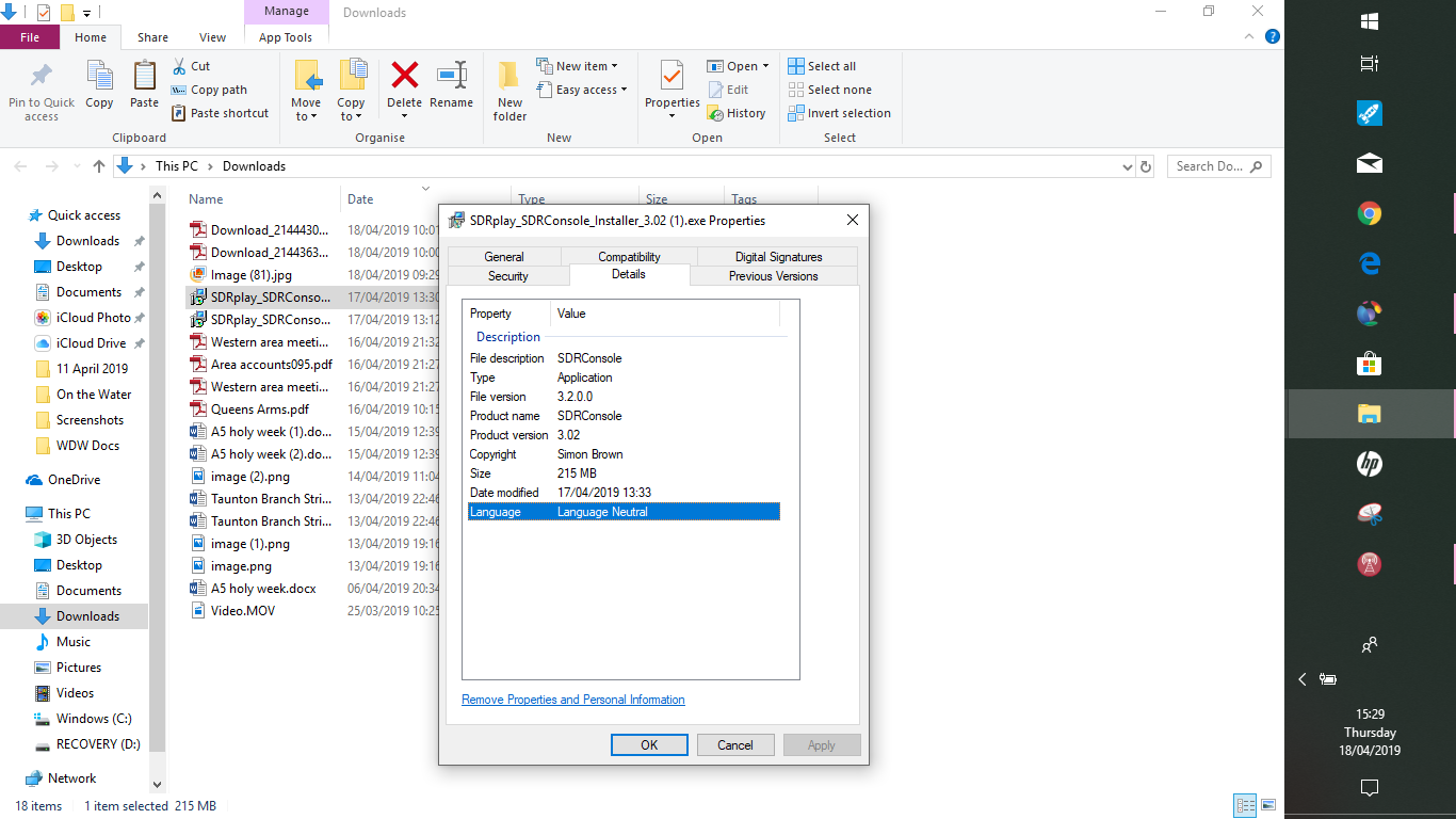

Screenshot (34).png (266.28 KiB) Viewed 12009 times
This is it Mike..Dowloaded today!Image
Re: SDR Console Lime transmit?
Posted: Thu Apr 18, 2019 2:46 pm
by g0mjw
That is 3.02 from last August. The version on the download page is 3.07. Here https://www.sdr-radio.com/Software/%F0% ... EDownloads
