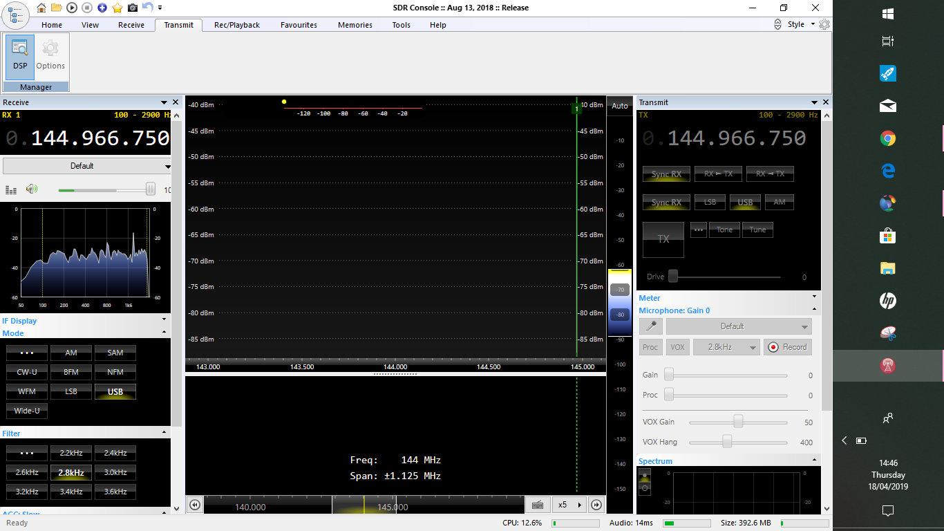

Like quite a few individuals I am guessing ..I plan to transmit low power SSB in the NB section of the Oscar 100 band.
To that end I have downloaded the SDR Console software and have this receiving OK
However, when I select transmit ..the transmit section is greyed out.
has anyone else had this problem, or knows how to make the Lime transmit SSB?? See attached[/img][/img]Image

Looks like an old version that does not TX. Download the latest from the SDR console website.

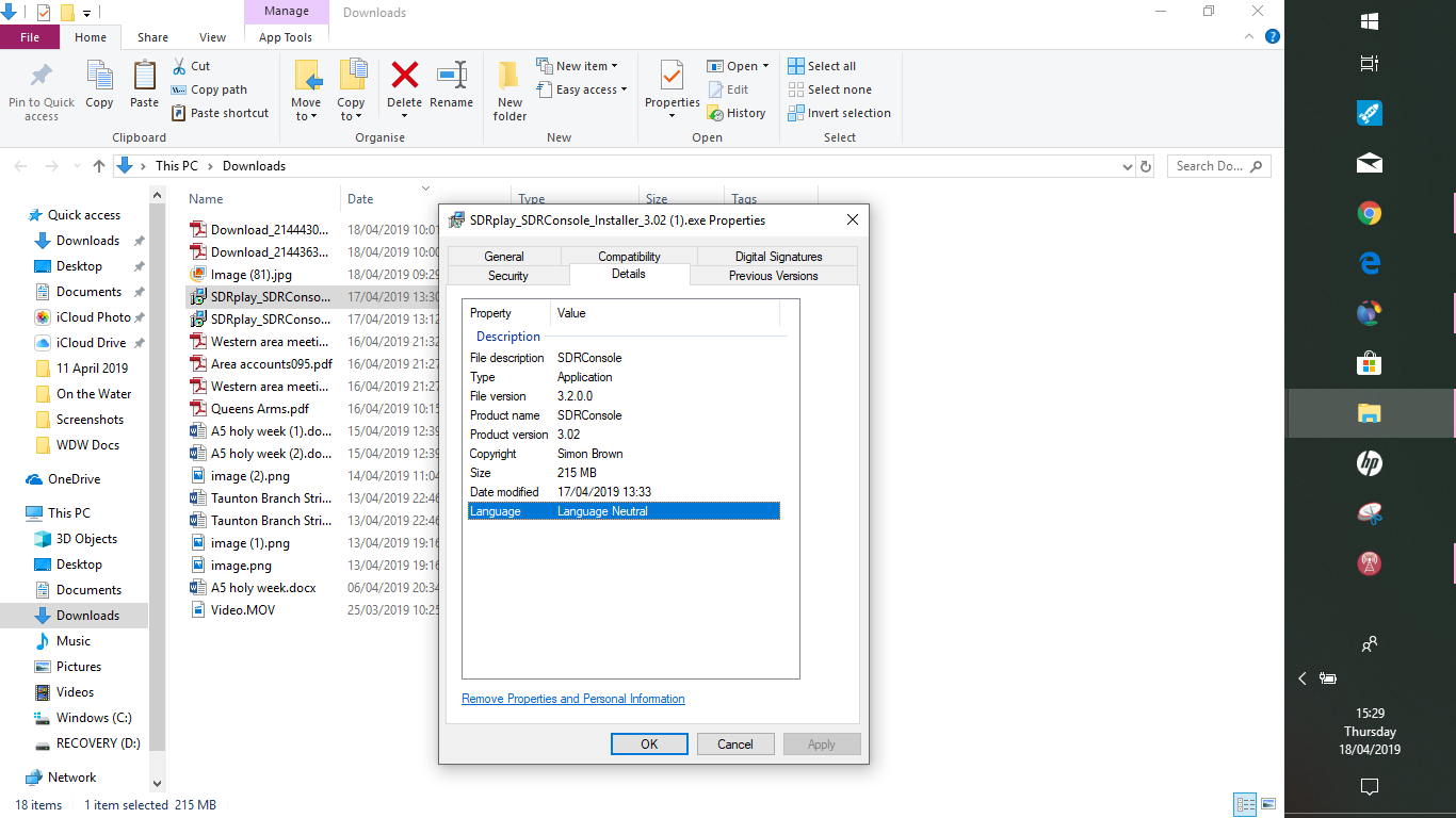

This is it Mike..Dowloaded today!Image

That is 3.02 from last August. The version on the download page is 3.07. Here https://www.sdr-radio.com/Software/%F0% ... EDownloads
